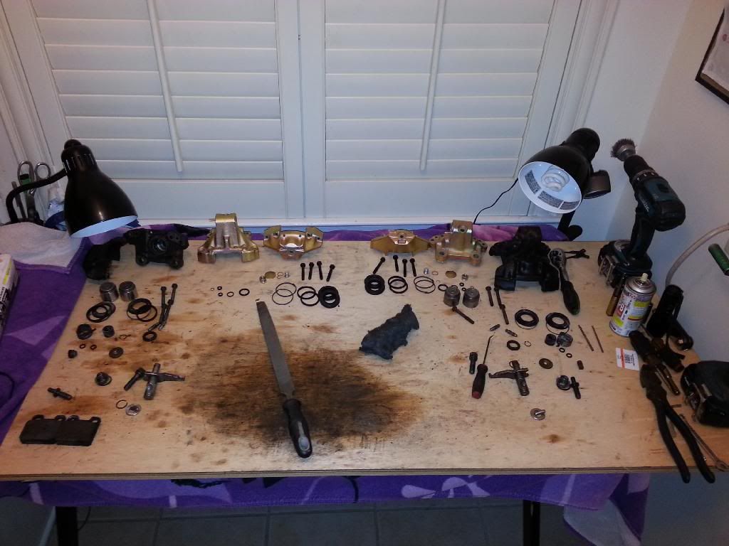

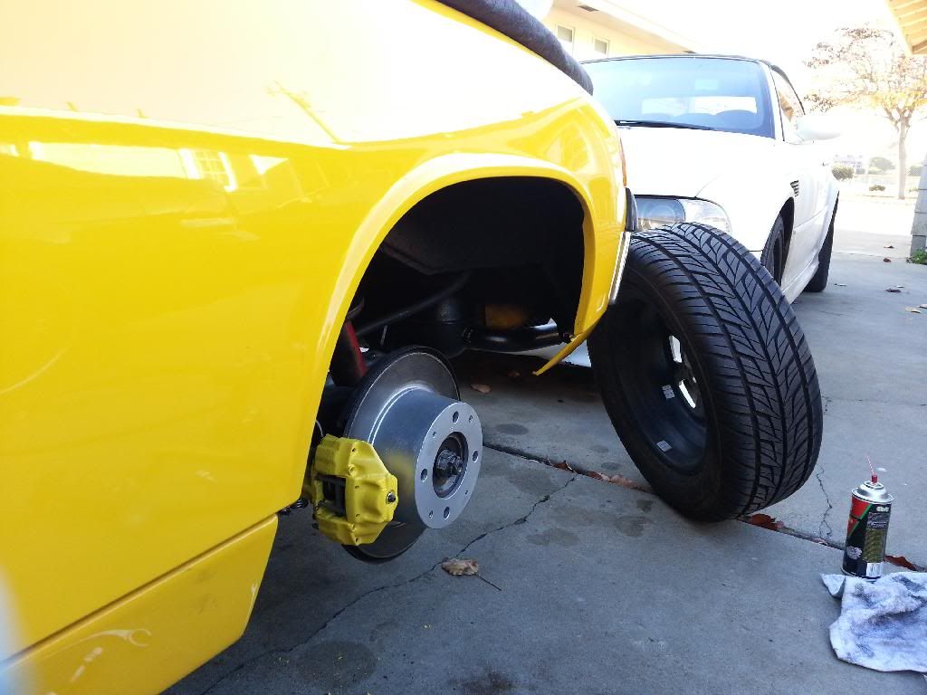

Well, I finally got around to tearing down my rear brake calipers to start the U-Do-It rebuild from PMB.
It has actually been a fun project.
My pins are all mismatched and 1 has the wrong OD.
Does anyone know where I could get replacements? The only place I found was in Atlanta and they want over $13 plus shipping per pin.
I will check with PMB today.

One of the pins in each rear caliper is too fat. That was done on purpose, I think to make sure that the pads went in the correct way. Unfortunately, pads with one larger hole have been NLA for quite a few years, so the typical procedure is to drill the one hole larger.
I don't remember if the fatter pin goes in the upper or lower hole, but it should only fit in one.
PMB has everything, most especially a very thorough knowledge of these brakes. Eric shouldn't steer you wrong.

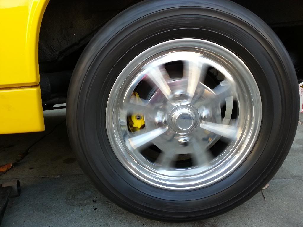

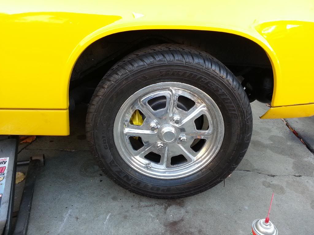

Although the pins are mismatched, I do have an original top pin with the fat sections in the pin for each pad and another fat one but it's only fat where it seats into the caliper; the rest of the pin is thin so maybe it rattles when driving or shifts when braking. I ordered some new hardware for the front brakes but I will see if they fit in the rears when they arrive.
So... finally I finished the rebuild in 3 easy steps:
Step 1: Remove, disassemble, and organize
http://i169.photobucket.com/albums/u...213_195438.jpg

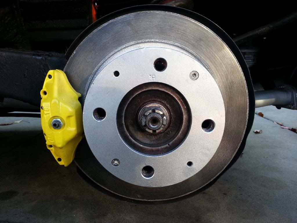

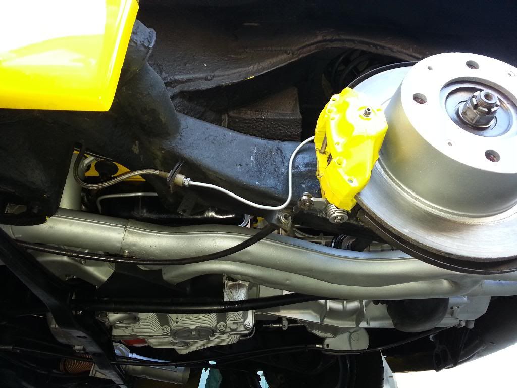

Step 2: Clean, Paint, Reassemble, and re-install
http://i169.photobucket.com/albums/u...222_142136.jpg
http://i169.photobucket.com/albums/u...222_145859.jpg
http://i169.photobucket.com/albums/u...222_150219.jpg
Step 3: Admire
http://i169.photobucket.com/albums/u...222_150752.jpg
http://i169.photobucket.com/albums/u...222_150826.jpg
http://i169.photobucket.com/albums/u...222_151028.jpg
http://i169.photobucket.com/albums/u...222_151033.jpg
Security system & quality inspector:
http://i169.photobucket.com/albums/u...2_150238-1.jpg

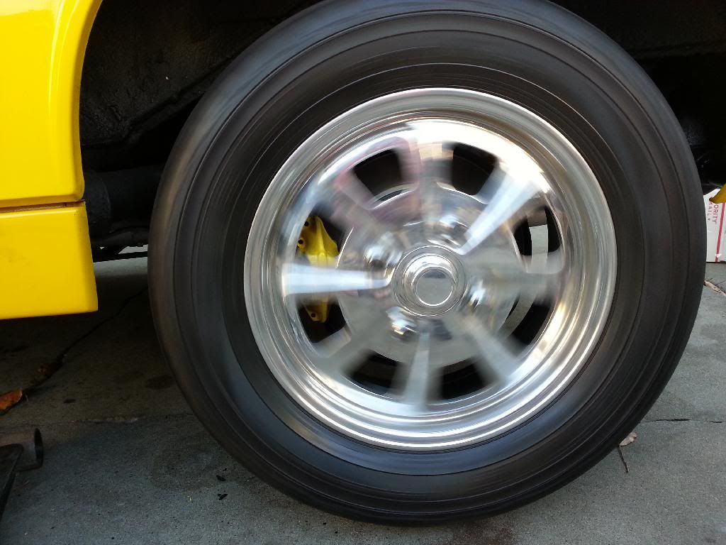

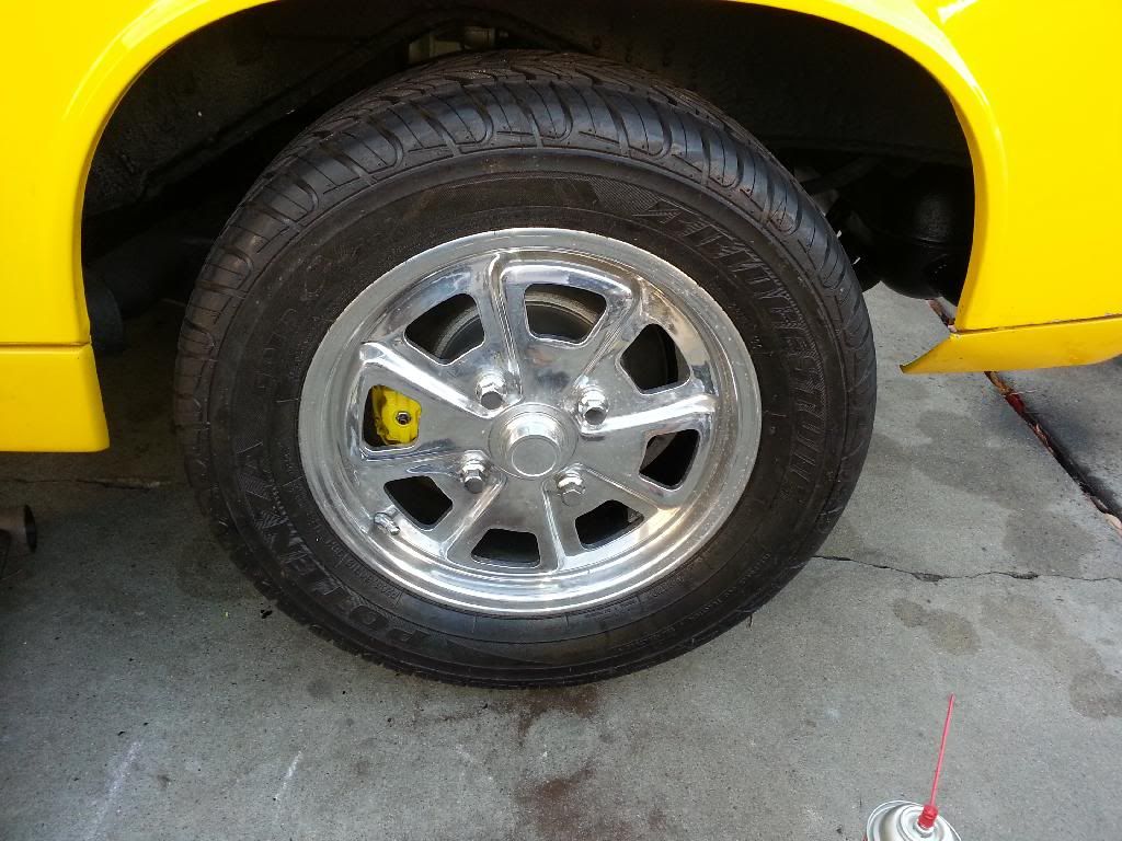

I was really on the fence about painting them. The PMB Performace U-DO-IT kit has a nice finish and I thought painting tiny calipers would be cheesy. I would also have to match the fronts but I ultimately convinced myself that it's just paint and they can be stripped pretty simply. Once I decided to move forward with painting I was on the fence about the color Black?; Why bother, they can't be seen... but having a gloss finish will keep them clean... and maybe they can be seen particularly if I put red Porsche lettering on them... but there isn't much real estate for that. Body color?; What if the color doesn't match... why illuminate such small calipers? Screw it... now is the time to paint while all the rubber is out, I don't have to hassle with masking, and since they are disassembled it will come out looking clean with no overspray.
I am pretty happy about how they turned out but now I need to paint the fronts too.
I still need to purchase and install pads... the ones I purchased at my FLAPS had a little metal shim to the sides of the backs that would have caused them to shift when the caliper pushed against it. I will have to order some from our host.
