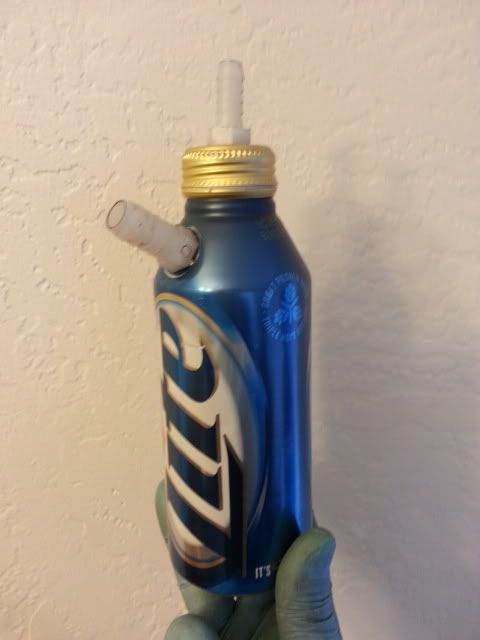

I made a catch can out of an aluminum water bottle that came with a bracket to mount to a bicycle frame. Close out shop for like $5.00. I cut the handle off the lid, drilled a hole in the middle of it and mounted a breather in the hole. The breather element I bought at Pep Boys designed for a small block Chevy. Look in the bling aisle.
From there I drilled a hole near the top of the bottle and put a white plastic 90 degree fitting that secures on the inside of the bottle. I bought that at Lowes.
After mounting the bracket to the firewall, I snapped in the bottle and connected it to the oil breather with a piece of clear hose. Works great. Although with the paranoia in California, I'd check to see if something like that is legal.

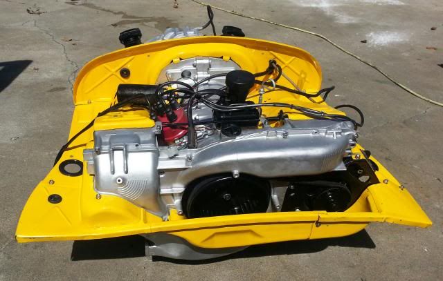

Some photo's as promised:
Motor & Transaxle without carbs - Front
Motor & Transaxle without carbs - Side

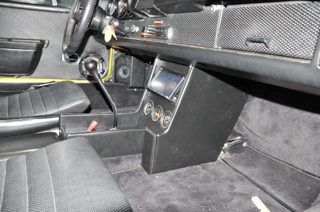

Miscellaneous:
Interior - Double-DIN Custom Center Console:

I did some research on the oil catch. It's a very simple system: oil vapor / mist in, condensed, collected, and cleaner air back out. The issue still exits as to where to connect the exhaust hose from the oil catch. I guess I will look for something that has an air cleaner / filter as the exhaust instead of an outlet for a hose.
Tip: The oil catches come in all sizes and prices. Get one with a baffle. The baffle will give oil vapor and mist something to which it can stick. Otherwise the mist will just pass through the can's outlet. I reqd that you can use steel wool in the cheaper cans without baffles but I would advise against it if you are venting the catch back to the intake because some wool could break loose and damage your motor. I found some baffled oip catches between $15 and $50 that I would trust.

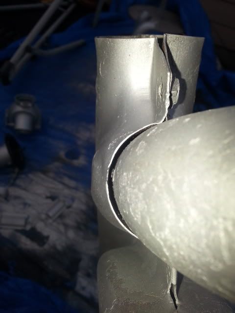

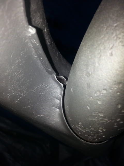

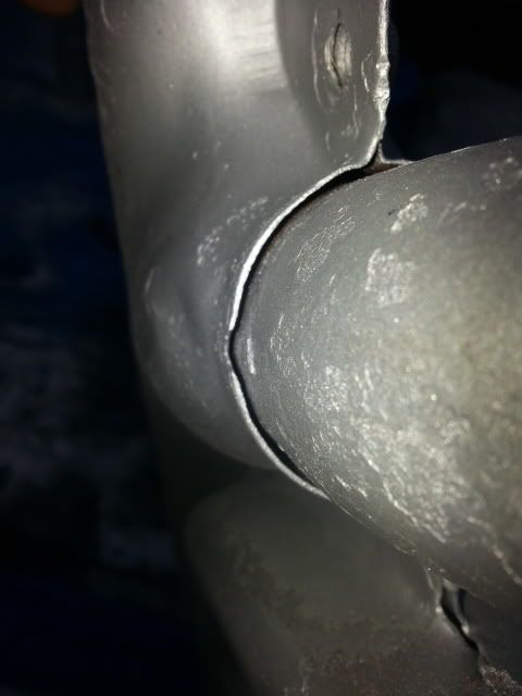

Heat exchanger question:
My heat exchangers have gaps at the ends of the chambers that feed hot air to the the cabin where air will obviously escape and possibly draw bad air. Are those gaps supposed to be sealed? I am thinking of using some Quick Steel to seal the gaps. Any thoughts?

It is best if you run the thermostat. It should help speed up your warm-up cycle at least a little.
Not sure exactly what you're talking about with the heater. More description, or pictures?

Some pics of the gaps in the heat exchanger warm air chambers:
Should I seal these up?

The carbs are in and I gave my son the project of building an oil catch. When he was done he walked out of the house to show me and said "Dad, I think I just built a bong." So yeah, I just gave a 16 year old some self miss-guided inspiration.
