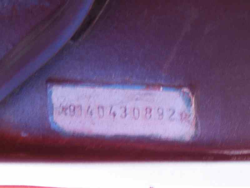

Small update, dose this look original ?
Old 03-05-2015, 12:36 PM
914 Geek
Dave at Pelican Parts's Avatar
Join Date: Dec 1969
Location: Silly-Con Valley
Posts: 14,938
It does. The VIN decodes as:
914 = 914-6
0 = 1970 model year
43 = Porsche Werk Stuttgart
2xxx = series number
It looks like this one would be fairly late in the 1970 model year run; it looks as if the last one in the 70 M.Y. was 2668, according to this website.

Be careful that the metal tag riveted onto the passenger side (above) is not the only tag you find to determine if the car is a Six. Obviously those can be removed and reinstalled with rivets. You should be able to locate the VIN stamped into the top of the passenger fender well inside the trunk, the VIN plate on the driver's side windshield post, the motor mount, the oil line bracket below the oil tank location, the ignition with on the left of the steering column, 5 lug hubs, etc.
