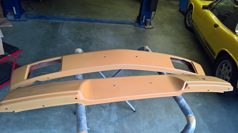

My plan was to replace the ugly rubber bumper with some metal bumpers.
So, I found a front and rear metal bumper and the top pieces in good condition. The bumper self were painted and need some work.

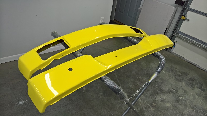

More work on the 914 bumper.
Got it primed and ready for final sanding and painting.
Here they are now painted.
Cheers
Engelbert

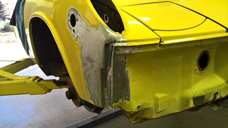

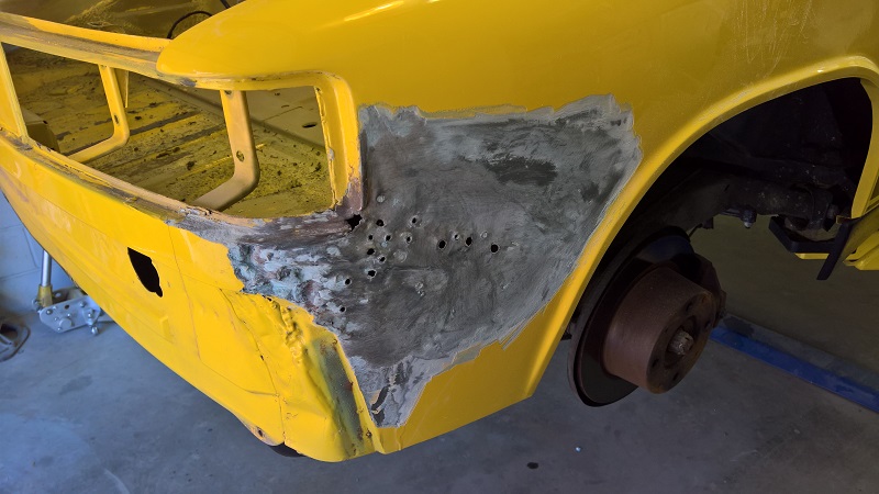

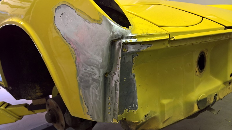

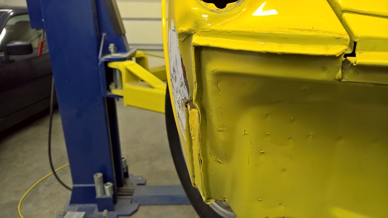

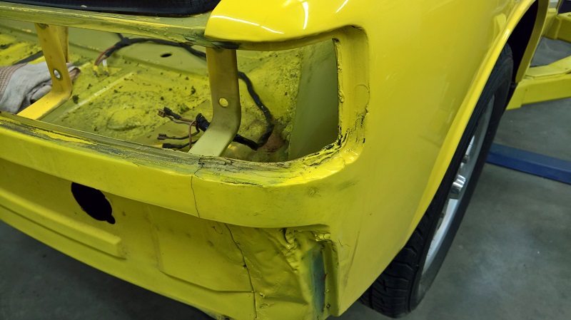

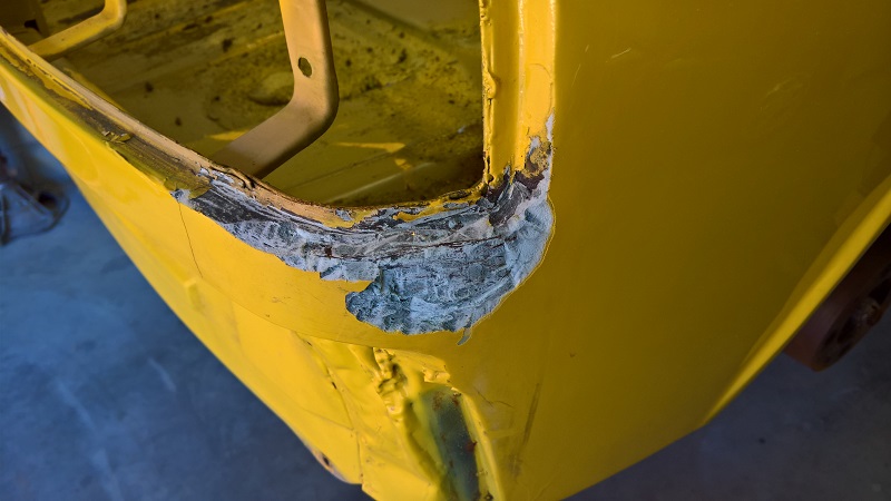

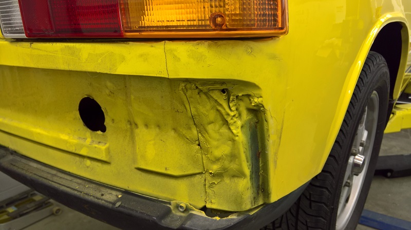

I got to the point to see if the yellow bumper will fit and started to remove the rubber bumpers and support. I know when I bought the car that something happen at that rear corner.
I did not expect that it will become such a project.
After seeing this, I started to dig in and get the body filler off.
Oh boy, somebody did some hi-tech repair.
Looks like I found a panel piece, so I can cut out the section and put in a new piece.

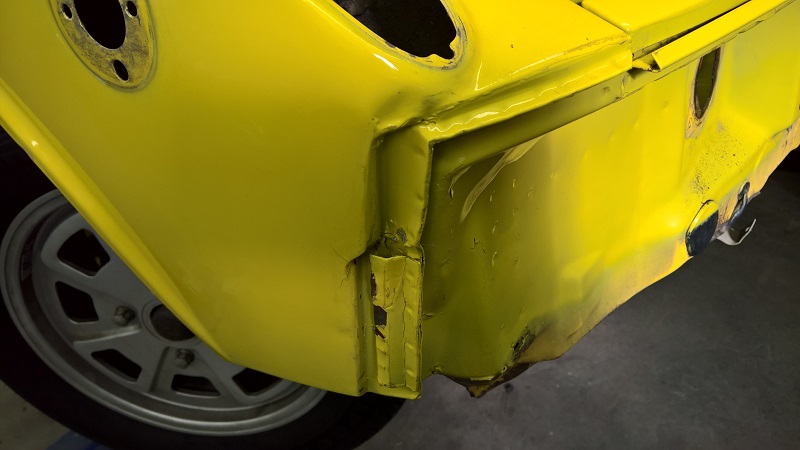

I want the piece first before I do any cutting. So I move to the front. At that corner it was also obvious that some repair was done at one time.
It was not as bad as at the rear end.
There were 3 holes when somebody tried to pull it out, so I welded the holes and massaged the rest.
While I was on it, I welded the side marker hole. I never liked the look of them.

I found a good replacement piece for the rear right corner.
Careful removed the spot welds
I found a small area which needed a little patch.
While I was fitting the new piece, I also made the patch.
One more small section to be fixed at the bottom, but no big deal.
Here it is, ready to get welded in.
I prepped the section of the car with some primer, chip guard, and paint, on the section, I cannot get easy later on.
Here is the new panel complete welded in.
Here is what it looked before.
Continue in the next post

With that I moved to the front bumper section. When I removed the trunk seal, I found some additional section, which need some repair.
OK, cutting out.
Welding in.
More pieces, this was above of the headlight cover, hidden under the trunk seal.
I painted that section for now, so I can concentrate later for the external section.
Cheers
Engelbert
