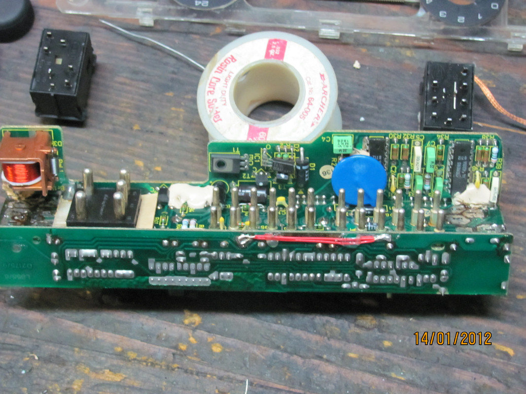

If the clutch is drawing too much current, it can fry a trace in the head unit.

im not sure if this is the case but maybe there is a self resetting circuit breaker in the circut to prevent a burned trace such as shown above?

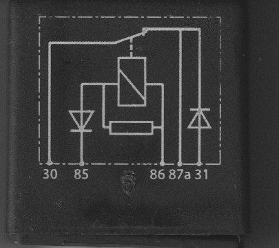

Ok, you all were correct. New ignition switch did not fix problem and provides no 12v to compressor clutch in the ACC position - or any other position.
AND I find something is burning up the diodes in my new $78 A/C relay. Contacts and resistor are fine, coil is fine.
Sure hope someone here has a clue as to what is going on......

Going to try to find a couple diodes and repair new relay myself. That's all that's wrong with it.
But I need to find out why the diodes both got burned up first.....
