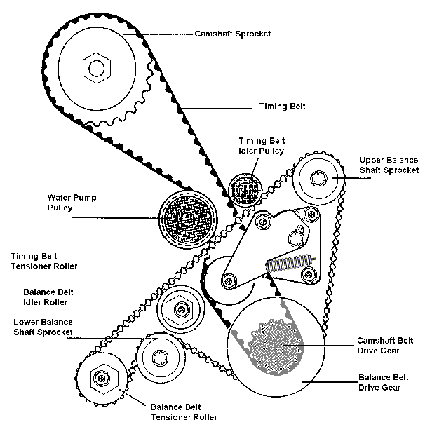

It has been a while since my last post here on the bird. I'm usually out on the 914club site. Anyways thought that maybe some of you could help me out. I recently purchased a 87' 944S with 61k original miles for $6000. This is a really awesome car, but I didn't have any maintenance records, so since I have been reading many posts about the carnage of what a broken belt can do, I went out and picked up the belts. I pulled the covers off and took a gander at the condition of the belts. The balance shaft belt was a little loose, the timing belt is in good shape but it is getting changed none the less.
My question is this. I tried to mark the position of all the adjustor cams for the balance belt. However in my haste I forgot to mark the bottom one and now I don't know what position these adjusters need to be in for the new belt. The adjuster seems to have moved and it appears that some sort of counter weight has turned it. Am I screwed? As the Haynes book does not seem to cover what to do when these move. I'm afraid to put the belt on and have the car all out of balance and the engine beat itself to death. Help a po old teener fella out will ya?

Why would you need to mark the adjusters? They have to be moved to adjust the timing belt or balance shaft tension. Do the timing belt first. Absolutely make sure the engine is on TDC as the engine will run rough if it's not. Once the belt is on, crank the engine over twice (with a socket on the crank puley) and go back to TDC firing on #1. the release the two 13mm adjuster locking nut and bolt and the adjuster will then set the tension. Make sure every thing is aligned and the timing blt is done. Then install th balance shaft belt and make sure the pulley notches align as in the book. Set the adjustment with either the "Krikit" or Porsche 9201 tool and again crank the engine over another two revolutions (with a socket on the crank bolt) and re-check the tension.
If it is not adjusted correctly, then follow the sequence again. Never just do up the adjuster nut without holding the large eccentric nut as both the tensioner will move or you will bend the stud.

You also need to pull the valve cover and check the chain and pressure pad. Most likely you will see some wear but not need to change the pad. Some do anyway at 60k intervals.
Here is a better diagram for setting the balance belt.

Hugh:
That is a great diagram! Now I feel much more relaxed in doing this task. I ordered one of those belt changing kits off of ebay, i.e the tensioner, and the two wrenches. Not bad for 80.00 bucks. That should make this chore a snap in the future.

You twist the timing belt and it will slide in/out of the gap between the pulley and the back belt cover. Done it many times.

There is no Bentley book (as yet) for this car. To loosen the belt tensioner: loosen the two 13mm bolts/nut and compress the tensioner. Once the belt is off the pulleys you then need to remove the tensioner off the crankcase. There are three 13mm nyloc nuts holding it on and they are difficult to see and undo. Use a 13mm 3/8" drive socket and ondo them, making sure not to loose the washers under the nuts. Then remove the tensioner. And go from there. I would suggest you get a workshop manual, or CD or copy of the belt replacement part of the manual as broken belts mean the car is worth $500 complete.
