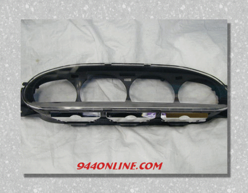

A bit pricey, but if you don't feel like messing with the mylar stuff and LED's you can simply purchase an entire new housing that will solve the dim instrument lighting problem as well as provide you with an unscratched /new plexi instrument cover.
http://www.944online.com/cgi-bin/ASI_Store.cgi?Product+skukey_1001675+9442+body-9442
