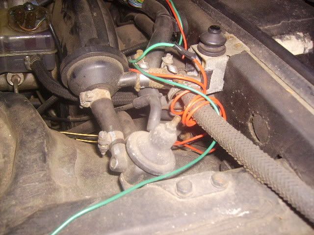

84' Idle Issue
Hi, new guy here. I am NOT mechanic at all.
I did just read another post about a members idle issues.
my problem may be similar but will post anyway.
starts fine. i typicly have to keep the peddle pressed to keep the car running to warm it up. after driving it a bit it will hold a normal idle for a short time then start fluctuating or stall. some times it will idle ok at a stop light, other times it will just die on me. there is a smell of fuel (rich) when warming the car up and im sure its there when im driving but just may not notice becouse im moving.
i have checked the vacume lines and they do seem to look ok. im sure the car can use a tune up which may help.
I have heard all kinds of solutions from idle stableizer to DME. i really need to track this down soon and with little expense. i have been buying parts that dont fix anything. could this be a timing issue?
suggestions would be very helpful. thanks in advance. happy holidays.

Welcome to the forum. Check out clarks-garage.com for more information on your car than you will find assembled in any other place. Also use the search feature as you are not going to be the first one with this problem. Make sure you find someone with an 83 to 85/1 car as those cars have minor differences than the later cars. What city do you live in....headed up your way tomorrow for a couple days.
Timing is set by the computer and is not adjustable so that is not it. The problem is probably a vacuum issue. There are many vacuum lines and they are everywhere including under the intake manifold which are the ones that are hard to see. You have an early car which doesn't have an idle control valve but something similar. There are a couple other things it could be but check all vacuum lines first.

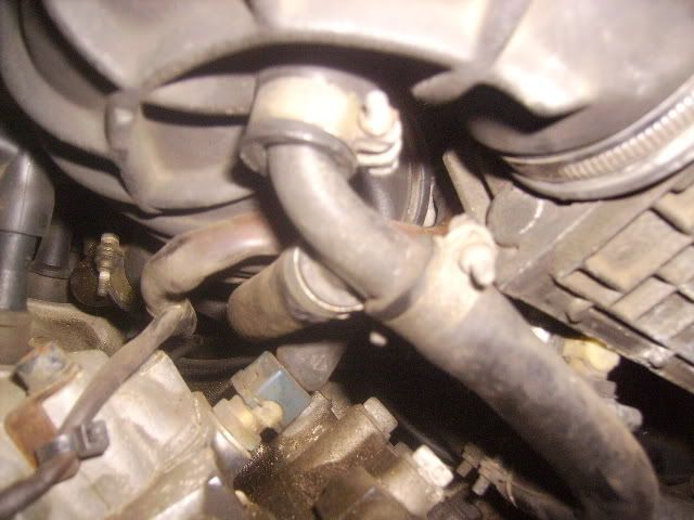

No ISV on your model only late models. You should not have to touch the gas pedal to start or keep running. Most likely you are having the common shudder issue on the early DME, try a search on that problem.
You mentioned the vacuum checks out but did you look under the J boot(large black ribbed hose) attached to the airflow meter? Look under it and check the port for a crack. This port will be apprx the size of a nickel and a steel tube inside it. That area is famous for cracks. Also check the 2 large ports on the same boot. One to the throttle body the other to the AFM, this area also develops cracks under the steel hose clamps. It will be best to remove the J boot entirely to see any cracks.
Diagrams to follow vacuum lines in case you do not have these for you to go by.
May have a throttle body leak too, only way to see that is to dismantle it and rebuild it with a kit....20 bucks USD or so.
Start there then if no success report back and we can move further, no sense giving you a ton of possibilities to add to the confusion!

wow. ok just checked the lines again. really they do look in good shape. dont have a j boot. the kid who had this put on some after market filter. i would like to replce it with all origional air system if anyone has one for sale. cheap. i purchased a DME and a throttle body off ebay.
I will probly swap those out just to cure my curiosity and to rule that stuff out.
im adding a pic of what im working with. This engine is dirty. it was owned by a 19 year old. When something stopped working, he by passed it. the glob of wires are to the fogs and to headlights.
Matt

What DME year is the one you bought, better be an early one or you will need the AFM in addition then a wire harness to connect a idle stabilization valve. No connector on the early harness is why.
AFM/DME Must be the same year and or model....late DME late AFM...early/early.
To convert to stock, look at the diagrams and determine what you don't have on the intake system now and pick those items up. You obviously need a J Boot and airbox.
To fix the shudder issue it is EZ if you go late DME/AFM than to use an adapter board. Try a search or ask the membership if anyone has a early 944 FR Wilk shudder adapter board. This item contains a "code" to solve the shudder.

You have the J boot. Look under it! See that corregated rubber hose in the shape of a "J" under it is a nickel sized port.
Is# 0 261 200 015 01 the DME # you bought?

Looked under the J and it all looks good.

Hate to say this but you will not be able to see any cracks from there. The rubber is flexible and you need to remove the line into the port then inspect the rubber by movement to see any cracks. It only takes a small one. The other thing I see is the gap on the left side of the port, could be seeping through.
Yep the new AFM not MAF, Airflow meter-Mass airflow sensor may be an issue but my money is on or to be exact, inside the DME/ECU....the famous 944 shudder and your symptoms reek of that common issue.

ok. i hadnt pulled it all off becouse i have to run around a bit. about an hour or so i should be back and i'll pull the J boot. anyone got an extra DME
