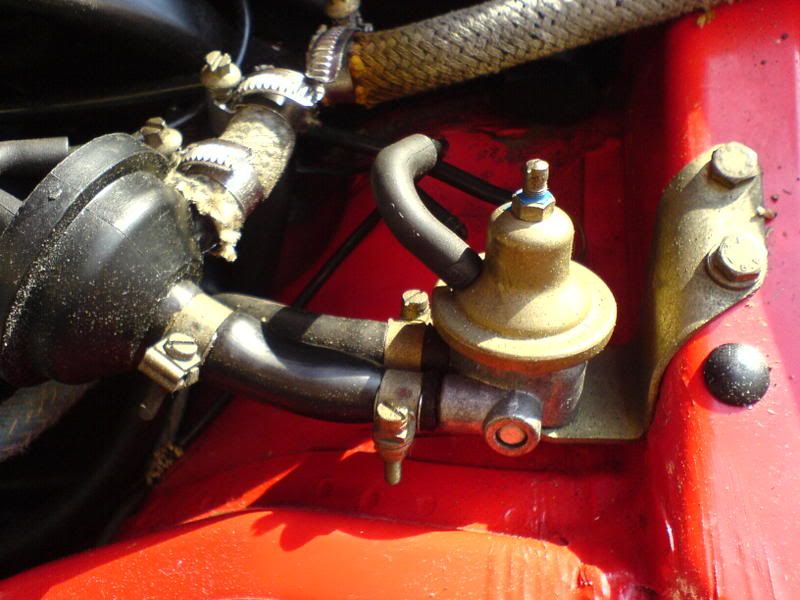

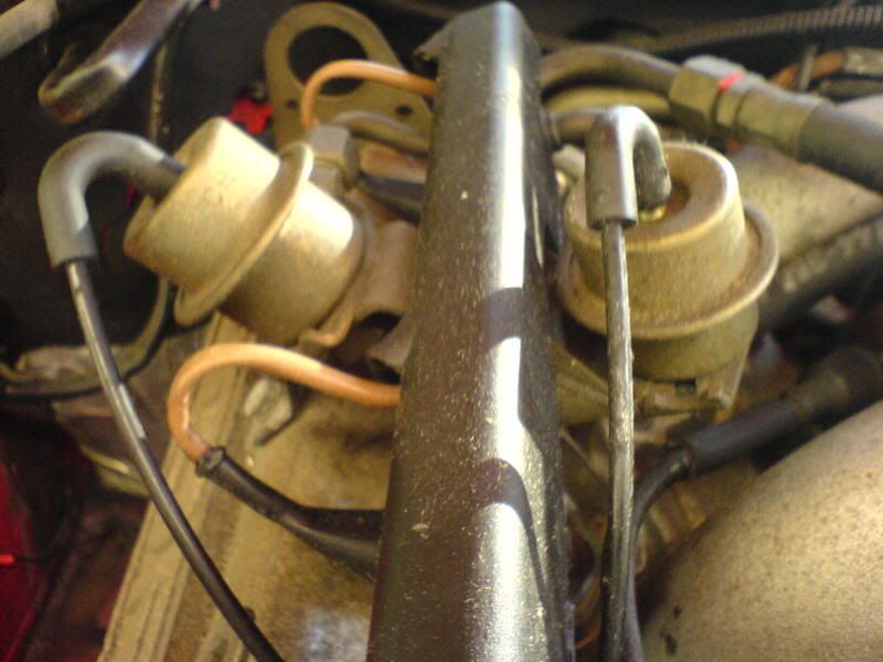

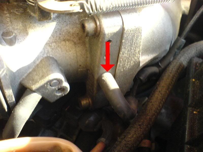

So, I seem to have stumbled onto what could be the source of my fluctuating idle issue... I was fiddling around with the AAV and related hoses without any luck, and decided I'd just start pulling vac lines off stuff and see what happened. I yanked a small line on the right side of the TB, and the idle instantly smoothed itself out, and settled down at 1250rpm (about what it "idles" at anyway on the rare occasion that it runs steady). I plugged the hole with my finger and it slowed down a few hundred RPM, but stayed smooth. At that point I noticed the line was dripping fuel, so I plugged it back in and the car died. I then followed the line up to the two pod-whosamajeggers on the back of the fuel rail, and also to some kind of apparatus over on the driver's side fender. No idea what anything is or what it does, but disconnecting them seems to have largely solved my issues...
In pictorial review:
I pulled this line...
Which split up and ran to these...
And this.
Ideas / hints / suggestions???

One or both of the whosamajeggers (fuel pressure regulator and fuel damper)at the back of your fuel rail are most likely shot and are leaking gas into the vacuum line. Pull the vacuum line off each, one at a time, attach a spare vacuum hose to it , and use your mouth to suck on it. The one that provides raw gas into your mouth is bad and must be replaced.

Seriously.....one or both are probably bad and you'll know immediately.

Just replace them both. If one is bad, the other is almost dead.
I just did the damper, and the car would take forever to start. Replaced the regulator, and things were back to normal.

Great example of what a few pics can do for a thread. =)
85.5 944 NA 5spd - Sold but not forgotten
89 951 Turbo S - Revival in progress...
Old 06-13-2008, 06:58 AM
AKCJ's Avatar
Join Date: Apr 2007
Location: Fairbanks, Alaska
Posts: 345
Yes, great pictures. You keep asking questions this well & you'll keep getting great answers!
Getting back to the story . . . what's the item in the last pic? I have one just like it but not exactly sure what it does.

My guess was some kind of regulator valve.
