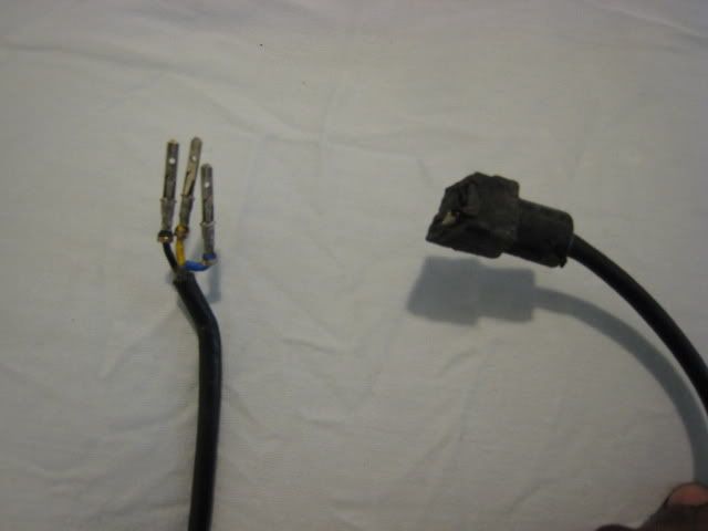

hello everybody, well I've been kinda busy the past few days but i continued the battle with the sensors although i was very careful one of the sensors broke with barely any force it just cracked so now i have to remove the sensor bracket which i tried yesterday but was only able to get one bolt out the bottom one is close to impossible to remove, i cant get anything in there to remove it I've tried allen keys but there is no space to move these around in there and i cant get the socket wrench to fit in with the socket that has the allen tip, and yes there has been blood, I'll post a pic of how bad the sensor is as soon as my cameras batt is done charging.
John_AZ any tricks on getting the mounting bracket off, it seems from the pic you posted taking the whole thing down seems the easier alternate but that's my an option for me right now

If your hex socket is too big, have you made one with a 1/4 in. drive socket by cutting the hex (to a length just necessary to fit in the pan head bolt + 1/8") and using a 6mm 1/4" socket? Bottom shows 3/8"socket/hex/setscrew, middle shows 1/4" socket and cut hex to size.
Either way the access from the top is horrible.
Option 1. I was able to crawl on the top of the engine, after removing or moving as many of the hoses and wires by the oil fill and sensor bracket....use my left arm to wrap around the top of the clutch bell housing and use a 1/4 socket wrench and hex to get to the bolt. It is possible because you will need to reset the sensors and have to find a way to torque the pan head screws now or at some time in the future.
Option 2. I would try to get access from underneath to get to the lower sensor bracket bolt. This involves using the hex socket with a universal attached to at least 2 feet of extensions to get below the TT.
If this is impossible. Before you tear out the clutch and bell housing-at least 2 or days for first timer to remove & replace.....
Option 3. Think about taking the intake manifold off to get better access. While this may seem like the second best idea, you should be able to work the bolt out from the top...
AND
have the experience of taking care of all the hoses under the intake including the AOS seals, cleaning and resealing the injectors, replacing cracked hoses, cleaning the ICV/ISV, new clamps, heater control valve, new "J" boot-maybe, and all vacuume hoses and connectors.
Cleaning batt grounds and a polish completes the task .

I just went thru this exact thing. After trying to get the bolts out, and drilling the sensor for a while with a flexible shaft...........I went and got a sharp chisel and broke the bracket out, cutting it just above the drivers side bolt. Done, after all that time. Got a bracket from APart Above in Strongsville Ohio from John. $25.00. When I spaced the sensors, I used rubber cement to glue a double thickness of matchbook to the end, and set it in the hole. Crank engine, matchbook disintegrates.
do it now, or do it later. Replaced all bolts with hex head metric new and anti seize.

I also used the chisel method, but I spun the hex heads with the chisel and hammer. Believe it or not, Ace Hardware had the exact duplicate bolt. Resetting the proper height of the bracket was done with a washer glued to the bottom of one of the old sensors.

well it seems like everyday I go a step further I run into more surprises, well the update today is i managed to get the other bolt out i climbed on top of the engine and somehow i did it and somewhere in the process now I'm bruised up to my elbows but i did it, now the new issue is that since the speed sensor broke in the bracket i cant take out the bracket so my question is do i have to cut the bracket where the "thingy" from the bracket goes into the engine where the lower bolt is located or is there a way to pull out the bracket without cutting anything, is this what u guys meant by cutting the bracket out, this sure has been an experience for me i guess its just a taste of whats to come. thanks
oh here's the pic of the speed sensor that broke off
