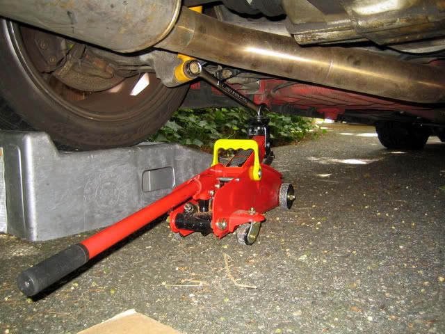

The bottom bolts can be a bear cause its tough to get enough leverage. This method has always worked great for me.. .
M474 shocks were rebound adjustable only. The M030 were rebound, compression and ride height adjustable.
Haha. I love your method, ha. Ok now what about the rear shocks? They have the same number as the M030 ones.
