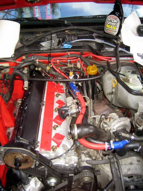

What needs replacing when removing the manifold?
I have to clean my ISV because it's not working properly. I hope it just needs a cleaing. the PO said it was new. I want to order everything I need so I can get this job done all in one shot or atleast try too. I know I need to replace the manifold gaskets. I also have to buy mounts for the ISV because the PO just has it laying under the manifold. Is there anything else that I will need to replace or should replace?
Thanks.

do you have a turbo? if yes, then replace all the vacuum lines with new hose. You might want to think about replacing whatever rubber is under there if it hasn't been done yet.
I was going to tell you about the ICV mounts...I replaced mine with a new unit and broke one of the rubber mounts getting it out...wish I would have known about those in advance.
Other than that, you can do a venturi delete if you haven't already...maybe even pull out your CV if you are using a dual port wastegate w/ manual boost controller? I pulled my CV out after I installed my Tial and replaced the line coming from the AOS with a long hose with a 90 degree bend I picked up at AutoZone.
That's all I can think of...

Basic intake manifold WYAIT:
AOS (air oil separator===oil fill tube) seals as mentioned. 2 "O" rings top and bottom.
Get new non perforated screw clamps or fuel injector clamps for all the hoses under the manifold.
Gap the reference sensors. Put tape over the TDC bell housing hole!!!, you do not want to drop a loose nut in the clutch.
Clean the negative ground and the small grounds near by. If the negative cable cover is cracked or full of acid corrosion, this is a good time to change.
Check the condition of the "J" air intake boot. if the rubber is cracked, it may be the cause of your idle problem. (NA $45--turbo $127-yikes!)
Have your injectors cleaned at www.witchhunter.com or do a DIY cleaning--see tech section at top of page
You will need to buy injector seals and hats unless you send the injectors away to be cleaned.
It is a good time to replace the heater control valve if you see white deposits of leaking antifreeze.
When you take out the ICV/ISV (idle control valve/idle stabelizer valve) mark the direction of air flow. Do not put it in backwards. Here is a cleaning DIY-there are others -look at idle valve test and other stuff for your 951:
