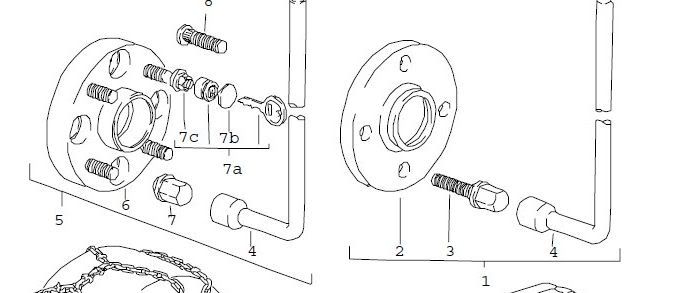

I have just diocovered porsche actually made a 15mm 4x108 hubcentric wheel spacer.
Its listed under accesories in the 924 pet catalogue.

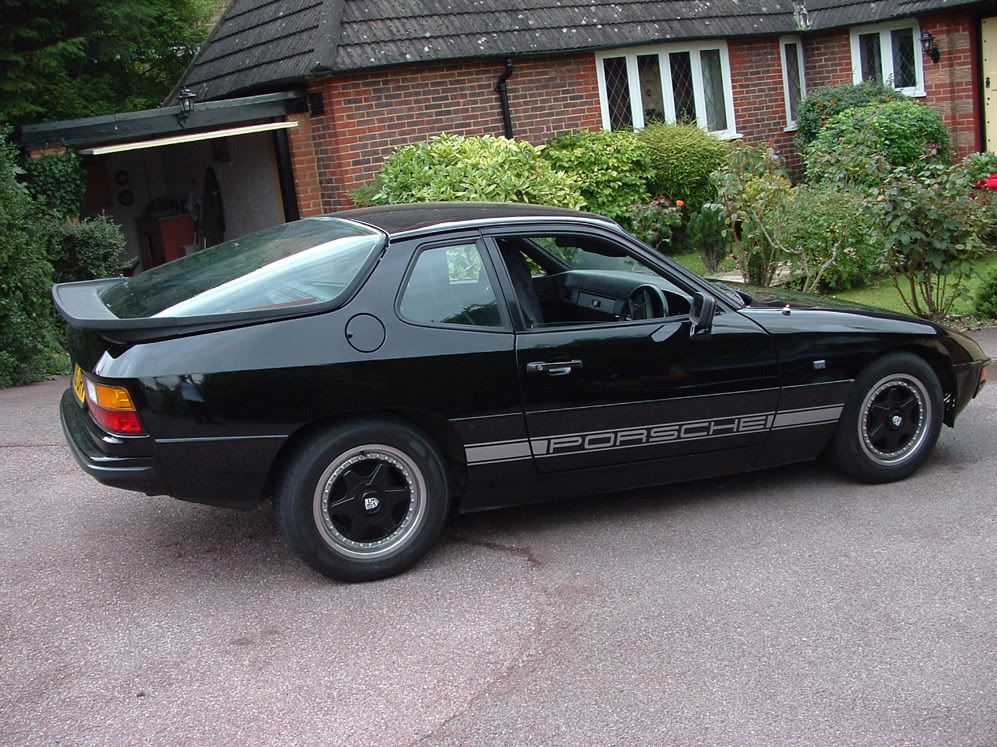

Right now im running on Audi 80 alloys which have the same centre bore but not the same offset, So i have 20mm universal spacers, But not hubcentric so i get vibrations on certain road conditions..
Im planning to order 2 of these just for the front. I will check 15mm is enougth to keep it off the spring.
And service my exsisting brakes to get the better braking i also wanted.
