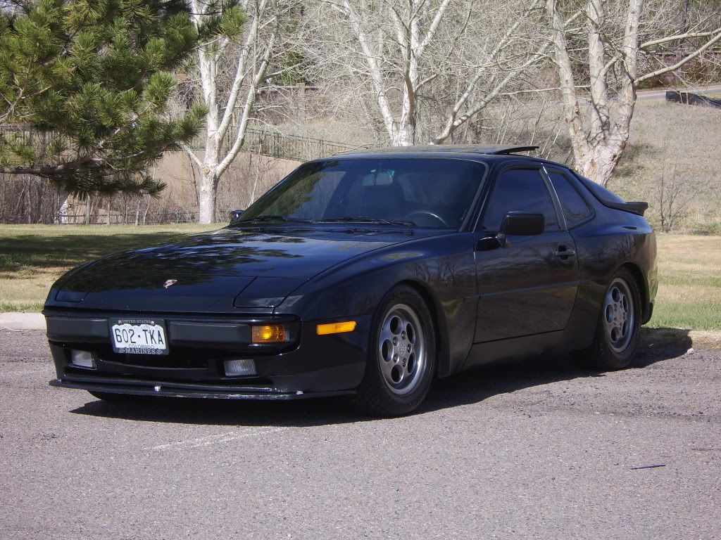

I stripped mine with aircraft stripper until all the paint and primer was gone. I then sanded the wheels with 220 grit progressively to 600 grit until they had a sheen that I liked. They have been fine for the last few years that way. I will hit them with a little sanding when they get scratched up. This is a lot of work, but it is cheap. You can paint them at that point or powdercoat them depending on your budget.

Originally Posted by VOLTRON View Post
That looks sharp!
