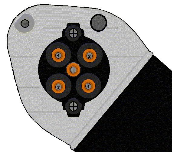

Backfire through the intake? Plug wires in the right places? Rotor properly secured? Speed/ref wires plugged into the right sensors? Did you gap the correct sensor (speed, NOT ref)?
