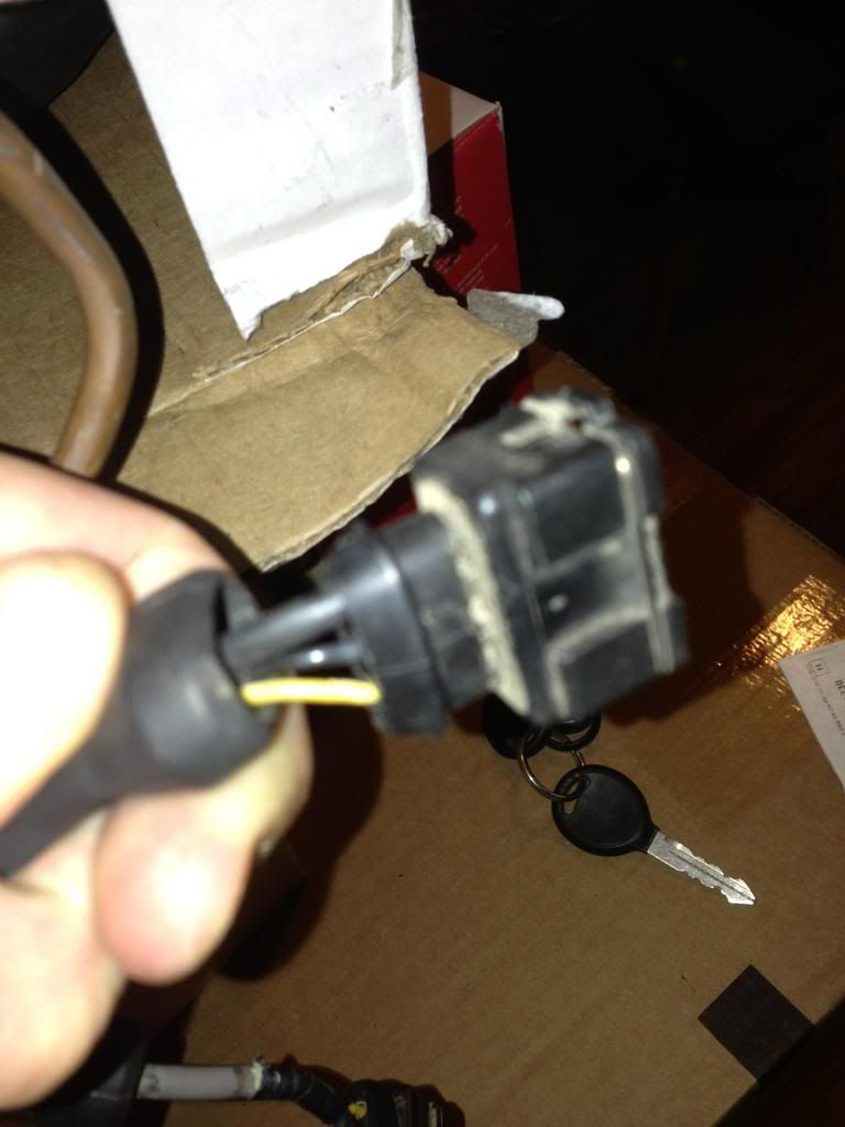

Hi there. I'm in the middle of replacing reference and speed sensor connectors on the harness side, i already bought and installed new ref. and speed sensors. I am chasing a no start condition on an '84 944 NA.
The harness side has yellow in the end, black in the middle, and the shielding wire at the other end, however the sensor side pinout has yellow as the middle pin. Does that seem right?
I even have a spare wiring harness and it has the same pinout on the harness connector; yellow,black, shielding. old sensors too are
black, yellow, shielding.

This is an old picture of mine---it may help??
Make sure you connect the speed and reference sensors to the correct wire DG or BG
Speed and Reference Sensors - Checking, Replacement, and Adjustment
No Start?
Before or after the sensor change---
"Does your tach needle bounce 1/16th of an inch while you crank the engine?
GL & welcome to Pelican
J_AZ

thanks John, I got the same diagram from clarkes garage and disassembled the old reference sensor to see what is what, however the problem lies in the above.
this is a picture of the harness side of the connector, as you can see on the sensor, the yellow is in the middle while on the harness, the yellow is on the end. is this the way its supposed to be?
