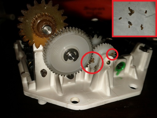

Odometer stopped working, 100kms after replacing gear.
I just figured out why. The big middle gear moves outboard and binds.
Made a video demonstrating the problem.
Late 944 odometer gear shifting - YouTube
Installing a washer before the c-clip will fix this.

What are the numbers of teeth on - I presume - the replacement gear at the left end of the assembly - the one everyone replaces?
That would be the smaller/inner gear and larger/outer gear?
How many teeth on the gear that touches the replacement gear?
Are any other gears replaced?
Did you apply lubricant or clean any off?
what specific year is the car?

It's an 86, so the oval dash.
Far left gear was replaced to do stripped teeth.
Lubricated the gears with instrument oil.
As far as number of teeth.... I never counted.

there are a couple sources for this info, and I don't have Pelican's listing in front of me, but I think Pelican sells from odometergears.com and I think odometergears.com is what I am remembering:
Odometer Gears - Porsche - 944 85.2-91
if that's the right year and country for your car, then:
"There are multiple tooth count options that can and will be installed in this odometer. You will need to count the teeth on the old gear before ordering. The outside gear will have 20 teeth and the smaller inner gear between 21 or 22. {If you cannot count the teeth on the main gear then count the teeth of the next gear that it meshes with. If your tooth count is 49: 20x21, 48: 20x22}"
... I can tell you I called Pelican about this, and they made for a super easy exchange of the incorrect gear for me after I got the incorrect gear. I can't recall the details, which I did write down, but the gear choice was actually a coin toss in the end I think because of what was known about what the original gears were, not because I didn't count anything. I also called someone at odometergears.com and the person - perhaps the owner, I forget his name unfortunately - were exceptionally helpful and actually fun to discuss the gears with.
I can't say the slipping you show will no longer happen even if the correct gear is there.
Last edited by Bukowski; 08-06-2013 at 08:08 AM.. Reason: clarify why the "coin toss"...
Old 08-06-2013, 07:30 AM
Volhv's Avatar
Join Date: Jan 2012
Location: British Columbia
Posts: 708
Thanks, Now I see what you mean.
I got the euro spec KPH gear from Rennbay.
Unfortunately I was unaware that there may be different tooth numbers.
If it stops working again, I'll have to take it apart, and do some counting.

It stopped again. 184 kms this time!
Figured out one more problem.
The new gear I got has 4 circular raised areas on its face. This is where the sprue and risers were. Unfortunately some material was left behind when they were removed, and that binds against the gear that I put the washer on.
Sanded them down smooth, so let's hope for the best. This it the 4th time I've taken the cluster apart.
Yet again I forgot to count the teeth. Hopefully I never need to.

Check the little "paddles" on the gears between the actual counters as well.
On my first ODO some were chipped, which allowed the big wheels to move around and bind, causing it to stop.

When I bought my gears from Odometergears.com, I had a bit of a problem where the odometer would not move. Took it back out, called Jeff, one of the owners, and he walked me thru the rebuild.
From what i remember, he said to make sure there were no burrs on the gears. Make sure they were perfectly clean and there was no residue or old pieces of gears, and I believe he said to NOT use any oil, as the oil actually can cause more stiction than the gears were able to overcome.
