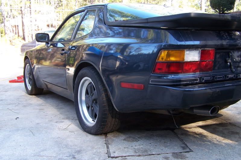

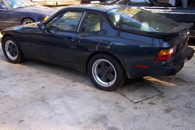

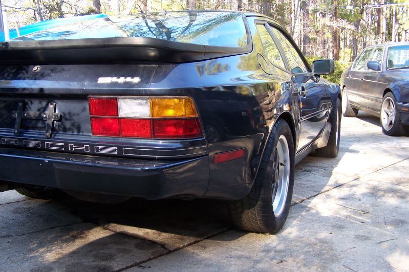

FT et36 on the 6" cookies 6"' Fuchs
FYI 15x6 Cookie cutters have an ET offset of 36 and will work on the front
additionally 16x6 Fuchs will also fit in front on a late offset 944and 16x7Fuchs will fit on the rear with its et23 same as the 15x7 cookies.

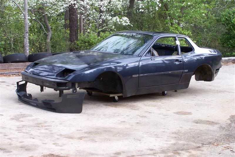

Below my 87 944 N/A parted and long gone...
Have a set of 16x6 16x7 Fuchs if you wanted to go that way ...

This is great, I love the look. Did you happen to try 16x7s in the front? Now I have a set of cookie cutters waiting to go on my car.
