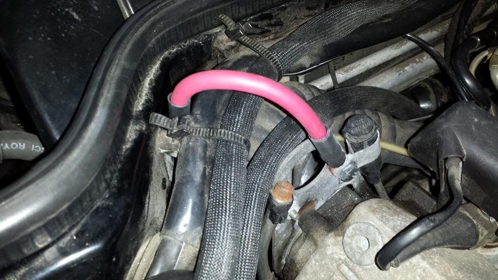

Since I bought my Turbo a year ago I have been chasing a bouncing temp gauge due to loading and unloading of circuits as well as varied charging levels despite a strong alt and battery.
I just installed the Ice Shark wiring upgrades and was having trouble getting a strong circuit to the starter.* At first I thought it was the positive, but by running cables directly to the starter and found it was the negative that was the culprit.* (despite having continuity between all grounds and the battery) Long story short I tried direct grounds from the battery to various body parts and got the same result with a ground direct to the engine as I did with ground direct to the starter.
The mod is a simple 6 gauge cable, six inches long, connected from the firewall battery direct ground and the end of the valve cover.* I simply used a longer bolt than factory for the fire wall ground and used the through bolt area as a lug for the new cable to the engine.* The firewall connection is actually a built in lug.
I sanded the engine side for connectivity and have a quicker start and much better gauges than ever before.* I also picked up an honest .5 volts from the alternator to the battery as I previously was getting .5 volts less at the battery than what the alternator was putting out.

IME, the extra jumpered ground went further to fix my issues than rewiring all else. The jumper running the neg direct to the alternator should not have mattered if the engine etc was properly grounded.

How/why does doubling the battery's grounding yield such good results?
And, if the lifting bracket is gone on your valve cover, do any other nearby contact points work well?

Therein lies your answer. You are probably not doubling the ground but in actuality finally making one good one after all these years! I'd think the screw mounts into the head that the bracket would normally attach to would work fine as well.

Possibly you missed nothing. I had already run a brand new neg cable directly from the battery to the bellhousing to replace the factory line (along with the big positives and the battery clamps) and that did not cure my issues. The 6 gauge jumper I made still went to the engine and theoretically should not have mattered but it did.
PS you can try before you buy by just using a jumpstart cable connected to the battery neg and clamp the other end to various places on the engine and see what happens. This is how I found that putting a jumper to the back of the engine would be helpful.
Grab your multimeter and check alt output, at the alt when running and then check directly at the starter (as that's where the output goes), then at the battery. In my case before the work I was losing at least 1/2 a volt when cold and more when warm. This pointed me past the alt to the wires. Personally I think there are gains to be had by running the alt pos cable direct back to the battery as allt to starter and starter to battery is a much longer path than necessary.
