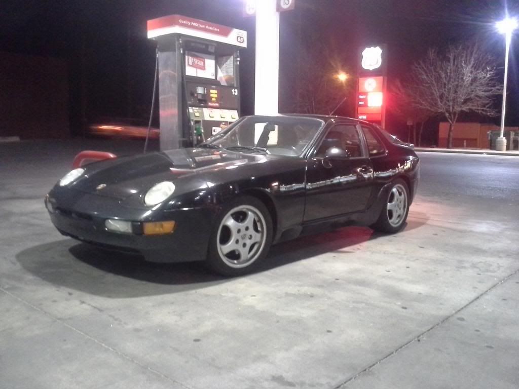

Hi everyone,
I though I'd start a thread about my somewhat recently acquired 92 968 coupe. It's black with 6 speed and 17" Cup I wheels. I purchased it for $3500 back in February and have put a few thousand miles on it. It's a great car and I love driving it! It has 211,000 miles on it, with head work done about 40,000 miles ago for a failed timing belt. Which also means it's past due for new belts.
A few pics:
Time for some much needed maintenance, adios "$3500 Porsche!"

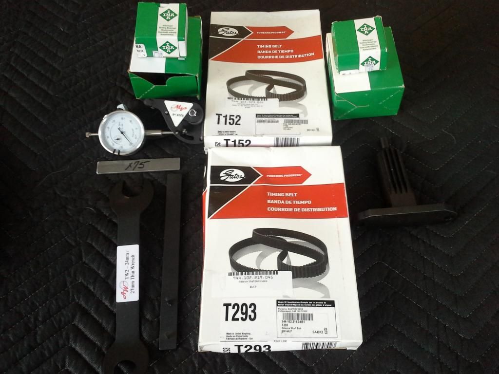

Tools, timing belts, rollers and tensioners:

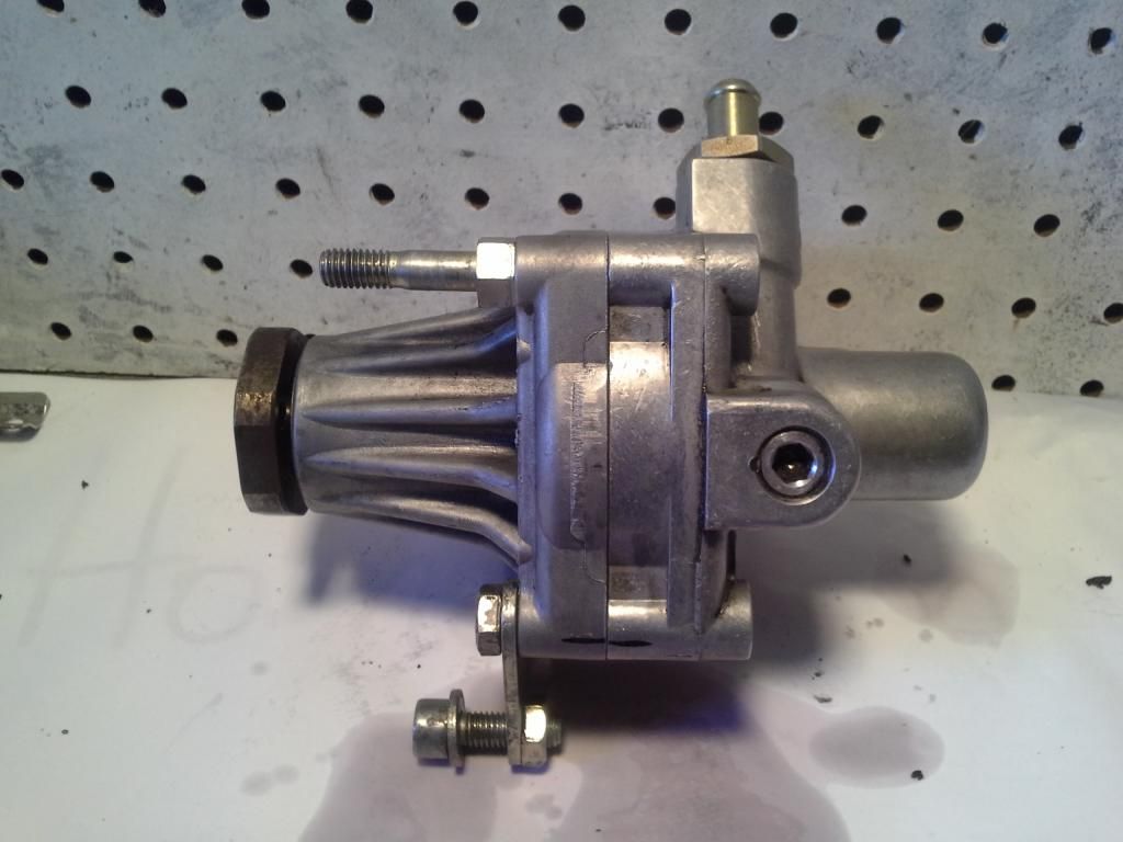

Power steering pump rebuild kit:

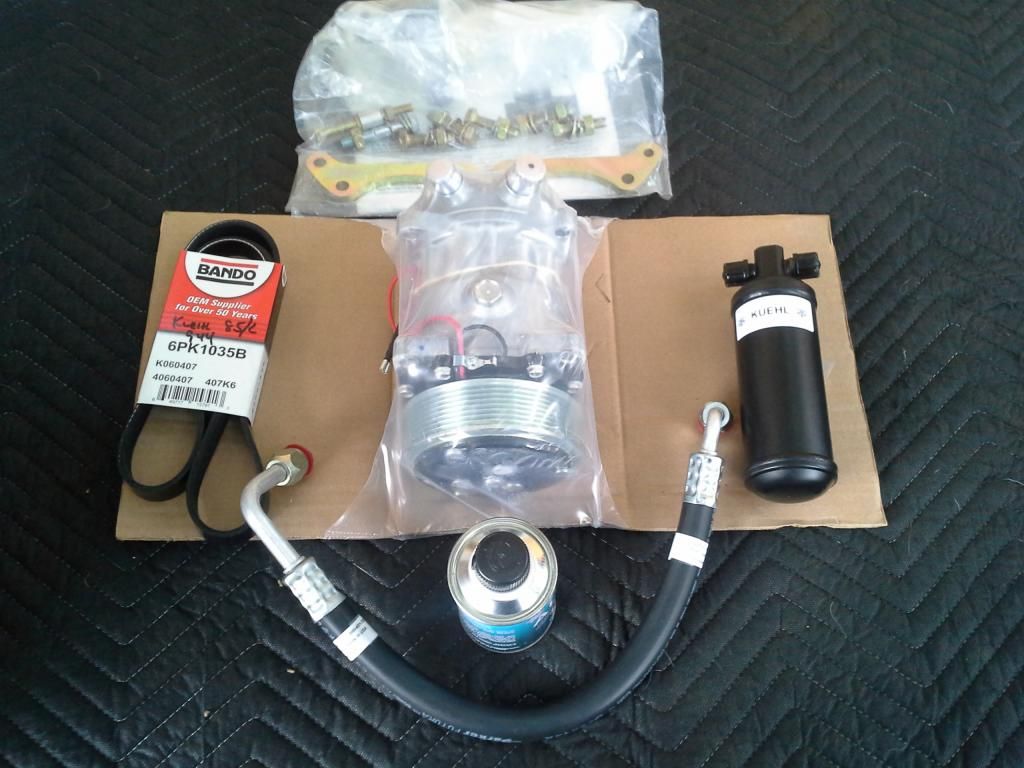

R-134 AC conversion kit:

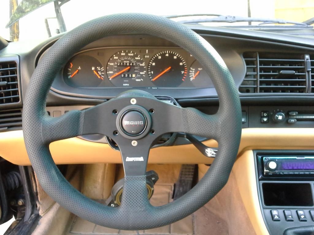

Just because, Momo Competition wheel:
And not pictured, but equally important, new water pump, gasket, and thermostat, as well as a new front crank seal.

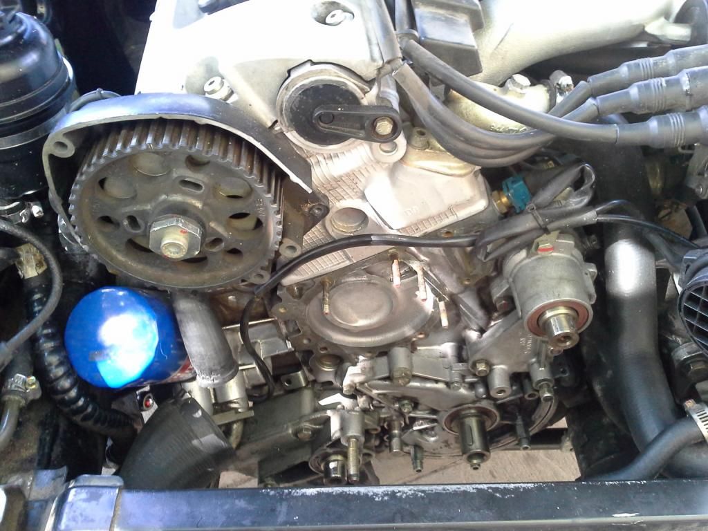

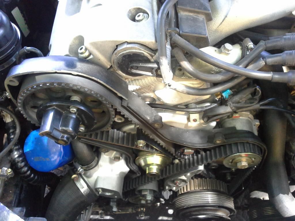

At this point, the timing set and water pump is removed and I'll begin reassembly today. Then next week, I have an appointment for a new windshield. Good thing for insurance, because that's nearly $1400! Clutch will be next once I stop financially bleeding.

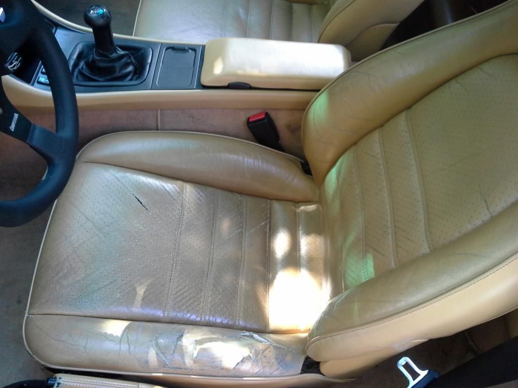

Let's see the interior pics...

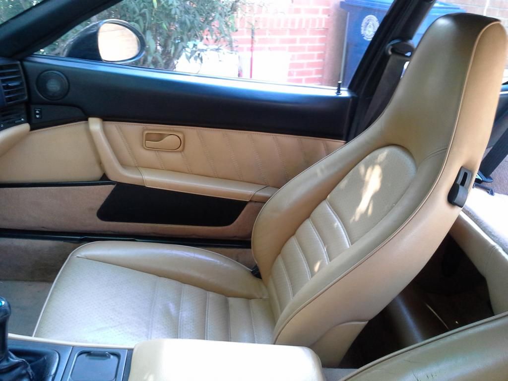

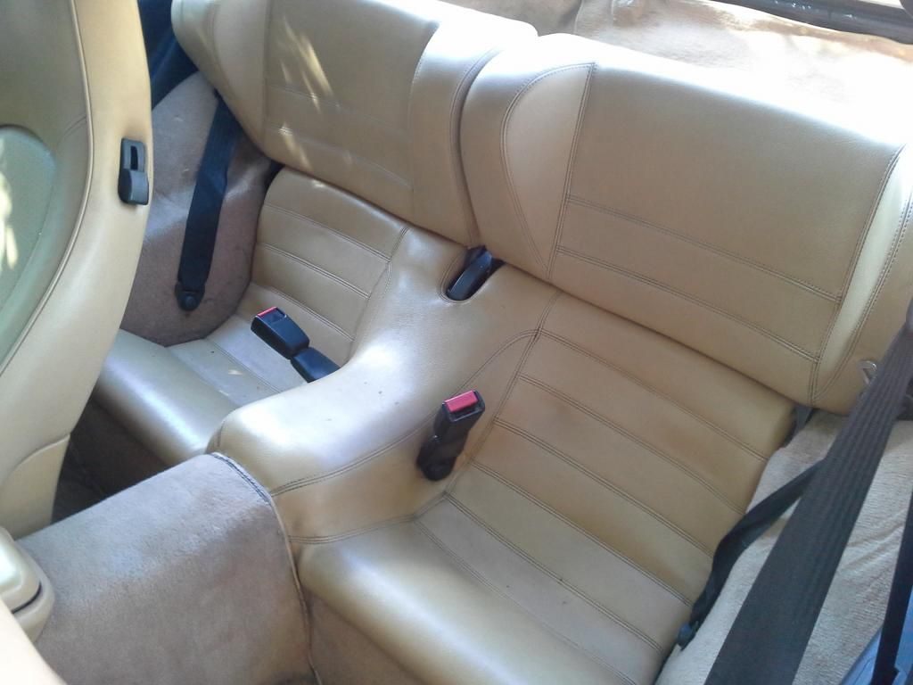

A few pics of the interior. Overall nice condition, but driver's seat is pretty worn:
Test fit of Momo Competition wheel:
Front of engine torn down:
Power steering pump rebuilt. Rennbay kit seems good, we'll see if that was really the leak:

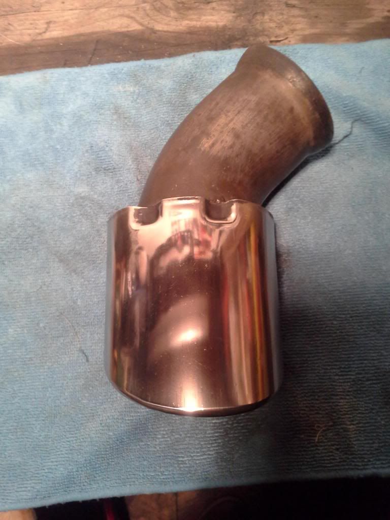

First "project" I did on the car; polish exhaust tip:
Final result looks copper in the photo, but it's a nice polished stainless steel:

I think and someone else might help with this, that early boxster seats will fit, which might be cheaper in the tan than getting the old ones recovered - or even go black!

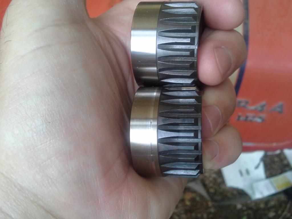

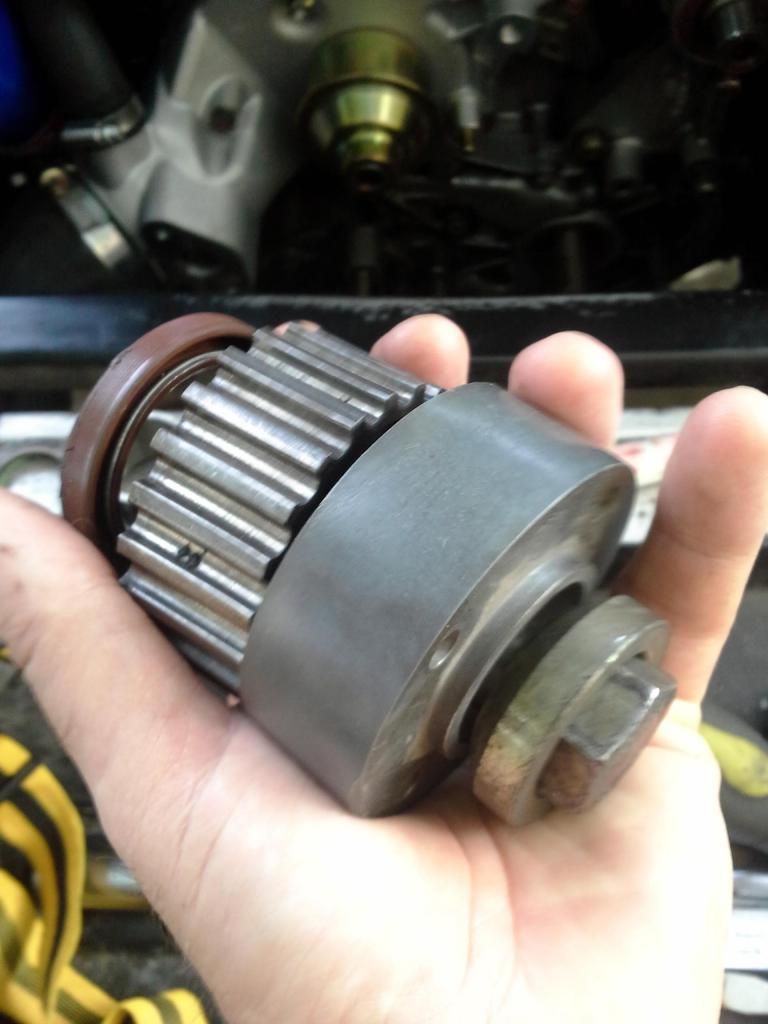

Here's a little update:
I decided to replace the front main seal and discovered that if the oil pump sleeve has wear that a new seal probably won't work, so had Pelican overnight one.
Prior to installing, I had to create a seal press. In this case, I used the old seal, the crank gear, and a fan spacer from a 67 Datsun Roadster. Tighten the bolt and seat the new seal.
New stuff in place.
The car's back on the road now and running great. The power steering pump seal kit worked great; no leaks. My efforts at reducing oil leaks, not as great. Still leaking some at the front, maybe oil pan.
Took the car to get the new windshield installed. They pedantically went through the car looking at the flaws, then when I got it back, they had gouged the dash in a corner, scraped up the leather on the new Momo, put my wipers on backwards, finished breaking the console lid, and did a mediocre job on the seal install. I insisted they buy me a new Momo, which they agreed to, but decided to let the rest go because I didn't want them touching my car again.
Also got a four wheel alignment with more aggressive settings, which was a very nice improvement. I'm planning to do a two-day track event next weekend, so hopefully I'll have a some pics of it in action.
