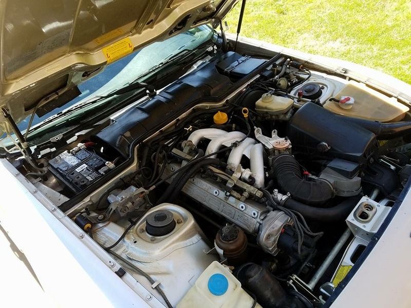

I came across my '89 944 locally and snagged it for $860. Car is in fantastic shape other than a dreaded oil pressure issue. Top end had an awful racket when seller started it for me, just to prove it ran. Sounded like it wasn't getting oil to the top end. After trailering it home, I immediately changed the oil in favor of 20/50 (Yes I have 1 post and can use the search feature! :typing after seeing several recommendations of this. Started the car and let it get up to operating temp, at which time the top end clatter was eradicated. Unfortunately, I do think the rod bearing (#2 bearing likely culprit from what I've read) is shot, due to cold idle having only 3 bar and warm/driving being between 0-1 with the warning lights on and the presence of a sound that I can only describe as being a cross between an exhaust leak and a vibration in the RPM ranges of 1200-2500 under load.

I'd think your rod bearings should be looked after immediately if you are planning to keep the car with the mighty inline 4. It's an excellent engine, that when properly maintained will allow you to drive quickly and at the limit. They are a racing grade engine from factory. But driving an engine with low oil pressure will cause other damage... as I'm sure you know.

I agree with above sentiment: change your rod bearings and swap the OPRV too. While you've got the pan off, replace the pickup tube gasket/seal and check the tube for cracks. After that it's just a matter of dealing with the stuff that needs attention in any old car, really. And timing belt changes aren't as scary as some would have you believe.
