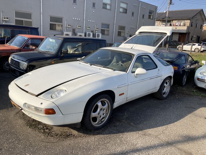

I'm about to tap out of this thread. I'm finding it harder to enjoy it. But before I bid adieu, I'd like to make a suggestion:
You've come across a batch of rare 928s. You haven't said if you're in the states or in Europe, but your 92 GTS is very rare in the US and quite rare ROW.
https://www.928oc.org/the-porsche-928/model-info/production-volumes/928-production-numbers
Worldwide there were less than 1000 GTSs produced in '92. How many are still on the road or road worthy 30 yrs later? Taking one of those remaining GTSs and turning it into a race car is such a shame. Even if yours was in sad shape (you haven't provided pics), there are guys over on RL that could have it back into shape in months. Its a car that should be kept as it came from the factory, not cobbled into a garden variety track car. Your other cars are similar - the shark community would love to have them as is.
I would suggest selling your stash of rare sharks and find an 87 or 88 S4 auto that drives nice but has a roached out int. Modify the engine all you want, bolt a 6spd Corvette transaxle on, and go to town racing that mother. With the money you'd make from the sale of your 3 sharks, you could easily find a race car candidate and afford the mods to make it go fast.
Once you get the cutting torch out and start making a rare car into a race car, the value drops like Biden's poll #s. And what's the plan WHEN (not if) you blow a rod out the side of the block? There aren't a lot of those GTS engines floating around. There are plenty of 5L engines to be had. Blow one of them up, not a rare 5.4L.
Feel free to call me a prude. They're your cars and you can do what you want to with them. But please consider what you're about to do and think it through. If this car doesn't mean much to you, sell it to someone who will appreciate it for what it is and do your thing on one that's not so special.

I fully understand that 92 Porsche 928 is a rare one and feel kind of responsible to keep it the way it originally was. At the same time, I would like to enjoy the car by extracting the potential without making a non-reversal modifications. I happen to have a spare 5.4 GTS engine which can be left completely normal. The entire car will be completely restored with the best paint job etc. All the interior will remain and restored or may be improved by leather upholstery etc. The will simply look fully restored 928 GTS but with modern performance. This is the direction I am heading. If so desired, every component can be replaced back to the original. I attached some photos of my cars to let you see my direction. they are all still under my possession.
I hope some of you can understand my direction !
