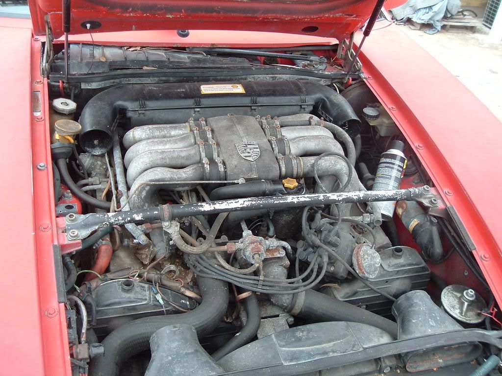

while trying to get my car running finally I ran into a few problems and have some questions. If anyone can supply answers it would be greatly appreciated. The list of probs is as follows.......
1: fuel pump was bad and a new OEM one is $350 so I'm goin to go the aftermarket route. so what is the typical fuel pressure rating for this car?
2: I'm worried about water pump failure causing major valvetrain dammage. Is there anyway to tell if my water pump is good or on it's way out the door? I only ask this because I heard that 928's are notorious for water pump failure. Are there any warning signs or does this happen suddenly?
Any advice will help since I know nothing about this car! Also I've looked all over and cannot find a service manual for the car. Does bentley make one?
BTW the car is an 81, heres a pic of the engine I don't know exactly what motor I have in it.

Pelican Parts (link at top of forum) lists the fuel pump for $209.45, there are aftermarket available but the price is about the same and you'll need asst. adapters to get it fit right. Go with OEM (Porsche PN# 928.608.104.01; Bosch PN# 0580.464.017[also Pelican Parts #])
I think the pressure is in the 40-60 psi range.
It's the timing belt failure that will hurt the valve train on some engines; your's appears to be the standard '81 US model, which won't suffer valve/piston contact on a belt failure.
Water pump failure is normally seals leaking, there is a rare incident of the impeller coming apart and damaging the block, but that's very uncommon. Most folks replace the water pump when they do the belt because the tension of the new belt can cause the seals to leak and it's such an involved job to replace.
I've replaced the belt on both my cars without replacing the pump and had no problems with the pump leaking. Your call.
See my reply in the "79 928 power mirror control" thread about the service manuals.
