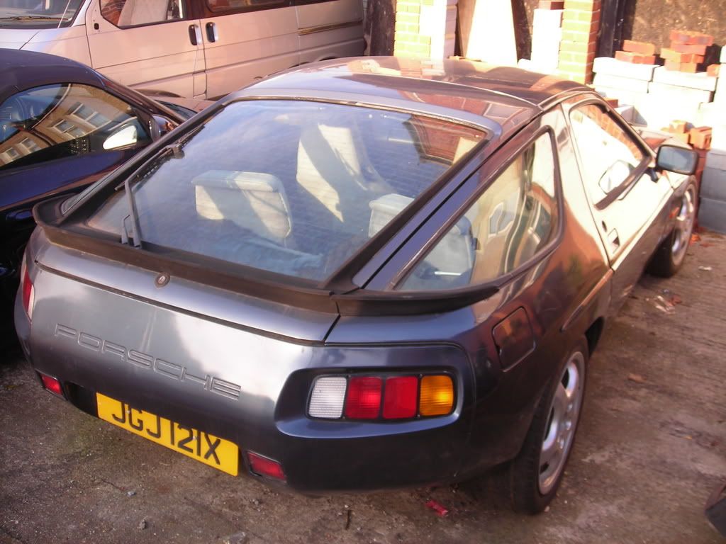

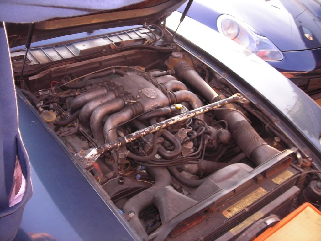

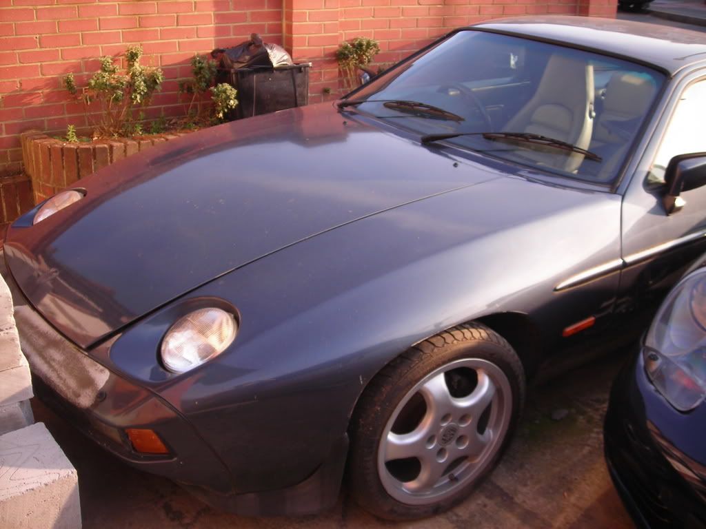

the vin no. is wpozzz92zcs841106 hope this helps, here are some piccies.
Old 09-30-2008, 02:49 PM
Network Native
Danglerb's Avatar
Posts: 10,349
Very nice, thats a Euro S, 300 hp, and no sunroof? Very nice. Is it a 5 spd or auto?
This is a car well worth doing it right, good luck.
