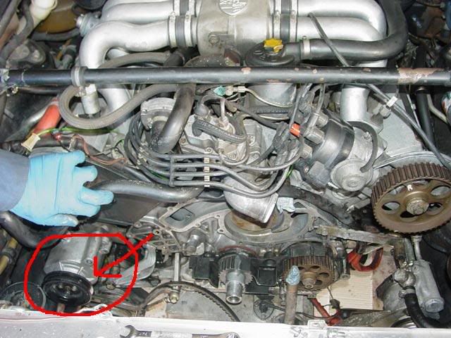

Well I found out one of the pulleys is seized, it's the one all the way on the left above the air conditioner compressor I believe.. can anyone tell me what it is exactly so I know what to replace?
Here's a picture of where it is.
It doesn't move at all, tried to move it but it doesn't when the car tries to start, the car suddenly shuts off, could this be why? and if someone can tell me what it is and how or what to get to fix / replace it.
That is your smog pump, for emissions, would NOT keep the car from running, the main pulley on the crank would just work the belt around the main pulley/fan pulley/smog until the belt snapped. Those are easy to replace, and even easier to just delete with a smaller custom belt running from the main pulley to the fan diverting the original smog pump altogether. I have a good smog pump that I would give ya cheap if you want it, just say the word.
Call it $40 + ship costs, hope this helps...
Thanks Tech I'll let you know, but guess I still need to find out why it won't start.. thought it was that.. any ideas what it could be? Should I get a video of what it sounds like when it tries to start if that would help?
There are so many points of failure here since the car sat that long, and the guys have given you TONS of info so far, please use it all to your advantage. The fuel is by far the most important, and like they said especially to play it safe. A vid of it cranking would not hurt of course, you can post it to youtube/cardomain etc and link it here.
But, keep plugging at fuel/spark, for sure, if it seems to be cranking healthy...
Also keep in mind as that smog pump does not play that serious of a role in the engine schematics it is part of your cooling system(viscous fan) so it needs to be either deleted or fixed, ASAP, to allow your fan to turn correctly as this V8 will get HOTT, fast, this time of year...
Do not play around with that, it will cost ya!!!
