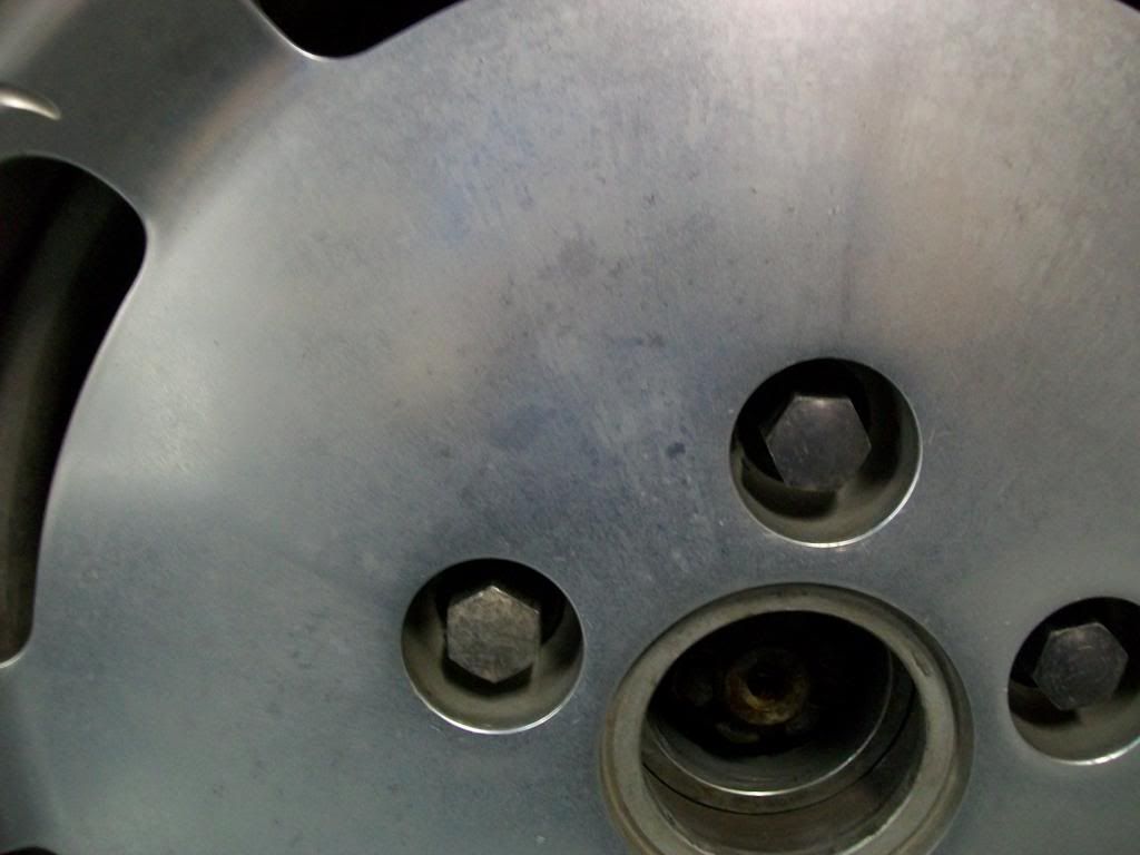

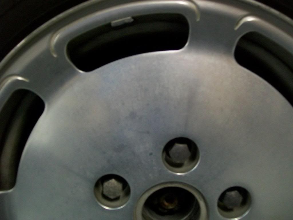

924 guy here with some flat dish/trash can/sewer lid rims. They appear to be anodized and are dull and streaky. I tried some basic mild cleaners and a lot of elbow grease but had little luck. I searched and couldn't find anything about cleaning these wheels. Any tips/tricks to getting these back to shiny or at least clean looking?

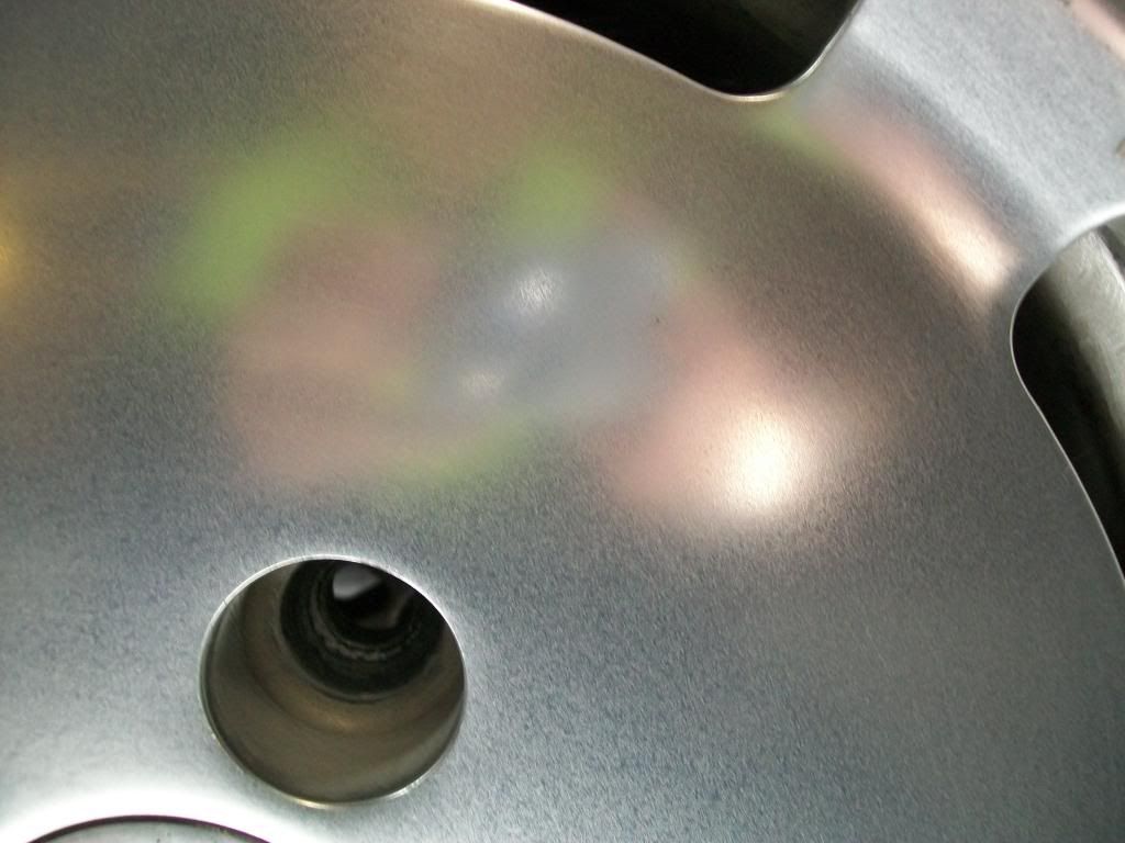

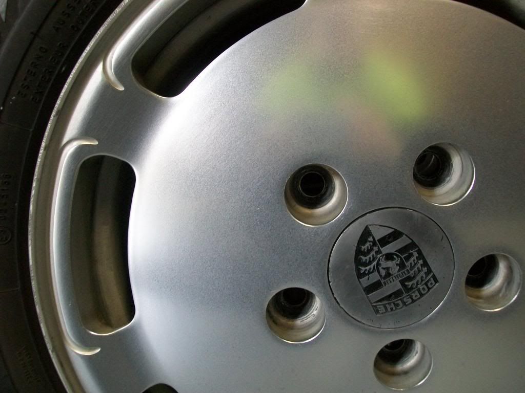

Well, after entirely too much scrubbing (mostly the back of the "slots" and slots themselves) the streaking and staining is gone. I had some brasso, mothers mag polish, and flitz in the garage. The mothers was almost gone so I figured I'd finish it off. I buffed the front of the wheel enough to get the streaks out and make a uniform finish, and slapped a little vaseline on for good measure. I tested the other 2 products out in small spots for a goof with no different result. Anodizing is a tough process. Short of going the whole easy-off route this did the trick. And I remembered that cleaning rims is my least favorite job.
