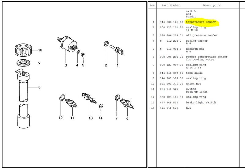

Old 05-21-2019, 05:26 PM
soxnail's Avatar
Join Date: Oct 2006
Location: Laguna Vista
Posts: 2,211
O2 sensor won't make the engine stumble....
Why don't you test the engine temp sensor first rather then replace it.

Old 05-23-2019, 07:58 AM
soxnail's Avatar
Join Date: Oct 2006
Posts: 2,211
Raulg,
You can test the sensor while it is installed. You are going to need a DVOM and a couple of cables with alligator clips on them. Car has to be cold (not been run and at ambient temp)
pic
Locate the sensor, you can see it looking down next to the hard pipe coming from the turbo.
Pics
Use a long needle nose to pull the spade connectors of the sensor.
Attach the alligator clips on each lug of the sensor.
Set the meter to resistance measurement.
and read the sensor resistance.
depending on your ambient temperature you will get a reading.
Table attached.
Now start the car and let it warm up, you should see the resistance on the meter display the temp to ohms relationship as shown in the table.
It won't be exact but any variation out side the range in the table means the sensor is, to use my technical term "Barfed"
Good luck, post results.
