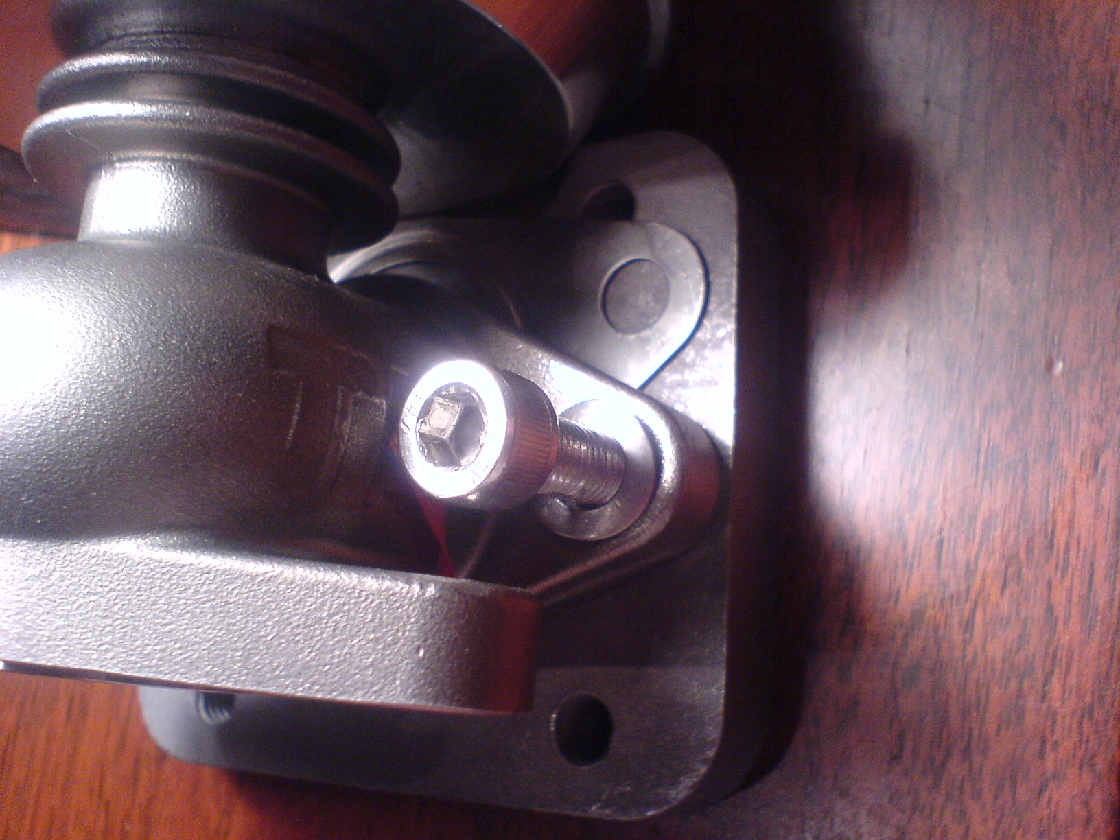

Ok well first off I want to get off my chest that I feel like the biggest retard in the world. BUT I don't even know what I did wrong. I got the adapter plates in today so I FINGER TIGHTENED the two bolts that came with the wastegate into the threaded flange then onto the plate.

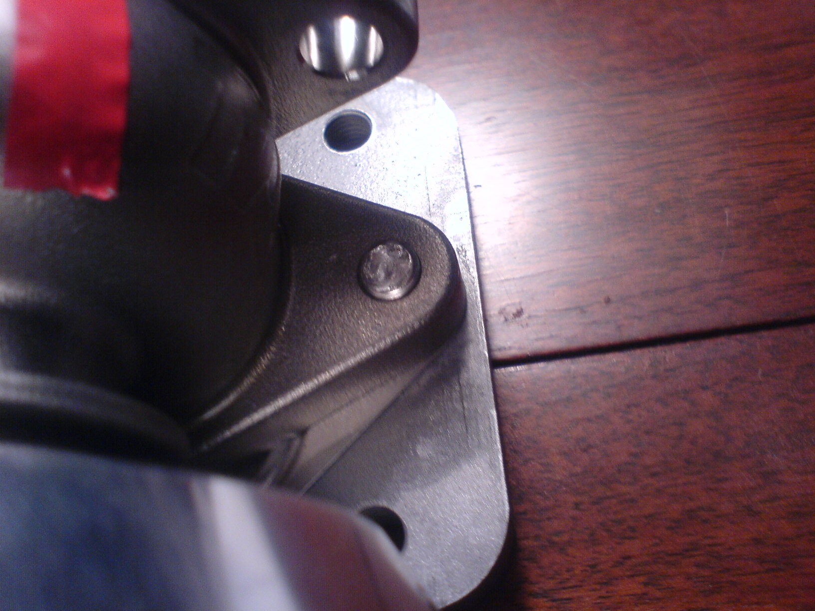

So I am ready to turn them out. Nope they wont budge totally locked down. Like the tightest bolt I have ever turned. How could this possibly happen? Want to make matters worse? The bolt just turned off. WTF I just want to scream. Why does this **** happen to me? What is the fix? A screw extractor is a no go since I was reefing on it with a 1/2" breaker to get it to turn just a bit.

Wrong bolt i'd say. That looks way long if I'm looking at it right.

These bolts came with the WG. The stub I have from shearing it in half threads great into the adapter plate... what gives?

http://www.estainlesssteel.com/gallingofstainless.html
This is exactly what happened and how it happened. I talked to a couple engineering buddies of mine. I assume the tial WG is constructed out of stainless otherwise my theory is shot to **** again. If so BOOO tial BOOO.

time to drill out the broken bolts. make sure you drill all the way through the bolt, then try a square bolt extractor.

Forget the square extractor type - they suck.
If you're going to have to use an extractor, pick up some good ones. These Snap-On extractors work! I've been using these for years and they have NEVER let me down. Use these sizes and start with the 1/8 drill bit extractor.
