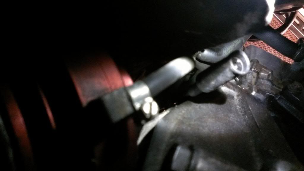

I need to pull the intake manifold off to familiarize myself with this car. So looks like the wastegate is a single port and is T'd off from the banjo bolt on the front intercooler pipe. Next to the wastegate was this connector just hanging here. Anybody know where this belongs? lol
Some sort of three-wire connector.
Yay... double checking vacuum lines/routing... -_-'

I'd vote for the O2 sensor. The plug looks kinda like that, altho it usually comes up the other side of the engine.
The pasrts you have will take as much boost as you can make. Of course, get it too high and you may blow your head gasket or have other catastrphic problems. Most people wouldn't push it past 18-20 PSI.
If you've got a manual boost controller, the cycling valve should be disconnected. The manual boost controller takes the place of the cycling valve.
The cycling valve controls the wastegate - limits the boost to (I think) 12 PSI or thereabouts.

I am having a hard time getting my bearings from the picture. The 02 sensor would normally be on the firewall side of the intake where the speed and reference sensors should be located in their bracket.
At the rear of the cam tower connected to the engine lift ring, there is often a diagnostic test port used by dealers back in the day. I believe it was for determining TDC. I think that is what this looks like. Not sure from the angle though.

Prob the O2 sensoer plug.
