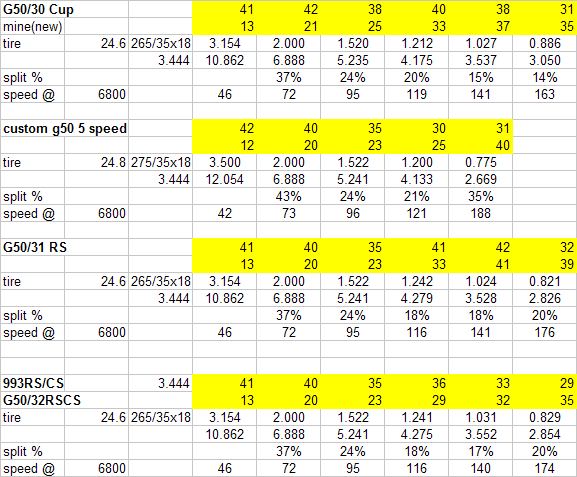

custom G50 5 speed
here is your proposed trans,
assuming that you are using 2-4 for track and 5 only for cruising it looks good.
3k in 5 = ~83mph
2k in 5 = ~ 55mph

... and I have a used 5-speed case for sale in the classifieds that you could use as the donor!

here's a comparison to the 993RS gearboxes
I do use 5 on track w/ mine w/ a G50/30

Here is a compromise 5 speeed
~67mph@3k

for comparison here is a G50/10 used in RoW 964RS
