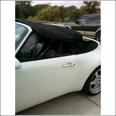

Today while my wife was getting ready to head out she started to put the top down. According to her, when she hit the button she heard a snap and, before she knew it, the driver-side rail behind her was bent. After this happened, she said she was unable to get the top to stow properly. Since I am in Iraq:banghead: I told her to take it to an indy VW mechanic in town who says he services Porsche's as well. After looking at it, he told my wife that he did not want to touch it because he did not want to be liable, so he told her to have it towed to Austin, TX (about an hour away) since driving down the highway at speed would produce some really bad results. I guess he called himself being helpful and instead of leaving the bent rail intact, he decides to take it off leaving the drivers side drooping. I told my wife to take it home and I would figure out what to do. I had her take some pics so I could assess the damage. From what i can see the only damage is the bracket. I found one and ordered it right-away. So my question is this: Has this happened to anyone before? If so, what caused it? I am hoping my brother-in-law will be able to come down this weekend and install the part and fix the problem. I am going to tell my wife to leave the top up until I get back. When i do return, what should I look for as a possible cause for this happening? Thanks in advance for your help.
BTW...are there any members in the area who can lend their assistance if my B-I-L can't make the trip? A p-car guy, or gal might be able to better assess what happened.
A few Pics:

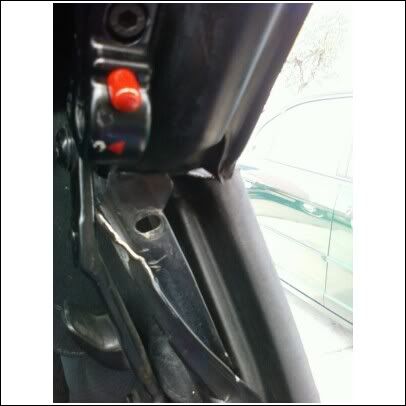

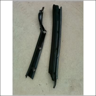

the bent bracket...that is the door seal on the right:
inside of car before the indy "helped her out"
the indy's handy work:

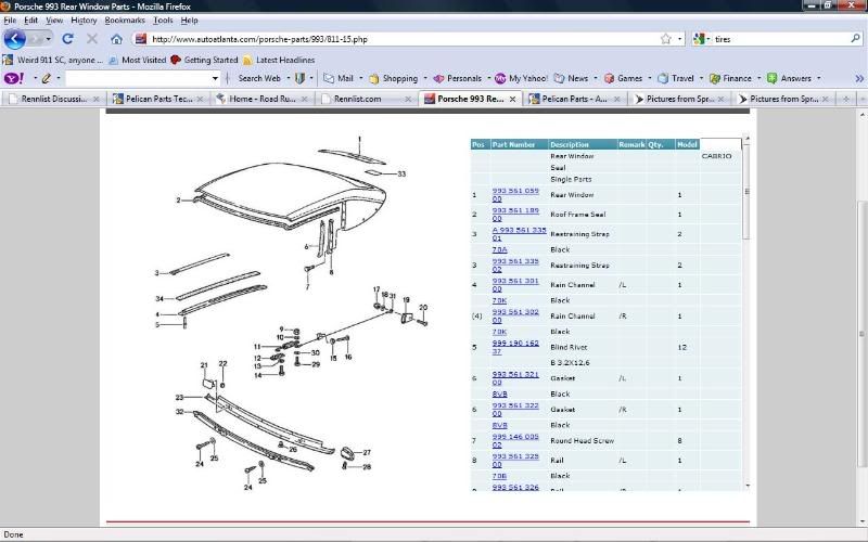

I ordered part # 8, is there something else that could have bent? According to my wife all else is good:

Did the B pillar break as well? On my 964, my B pillar snapped. This seams to happen on the 964's. The bracket that holds the seal on mine bent bad as well. If your B pillar cracked, finding a used one separate from the main top frame is almost impossible.

She said nothing else seems to be bent,she felt all the way around the fabric. Would it be obvious by touch that the pillar was cracked? I will have her check again to make sure...Which one of these is the B pillar? Thanks

UPDATE: The top is up. My Brother_in_law found that the b-pillar is broke on the drivers side. So my wife will have to get by with the top being down until i return. I found a used b-pillar and will order it on Monday. Has anyone replaced the b-pillar or know where i can find some DIY instructions? Thanks
