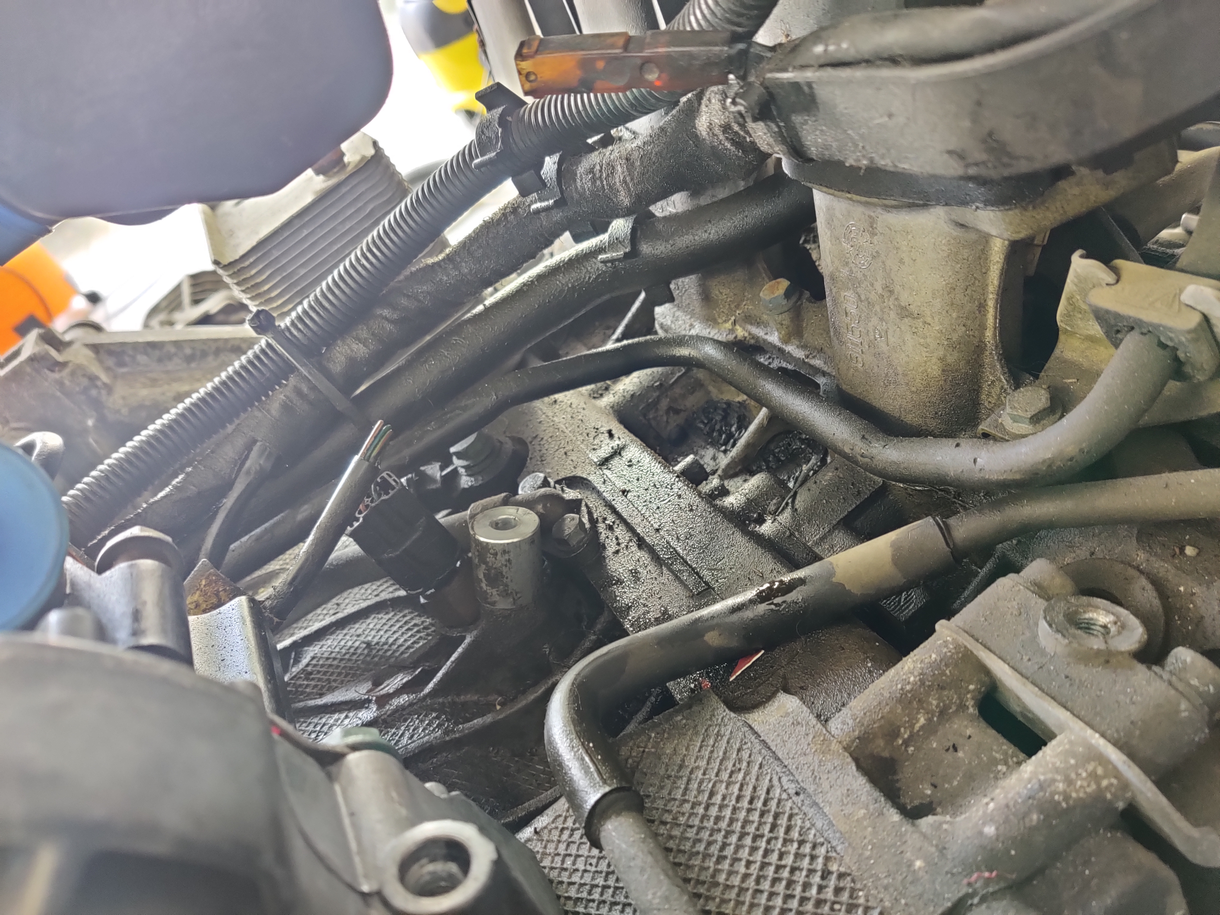

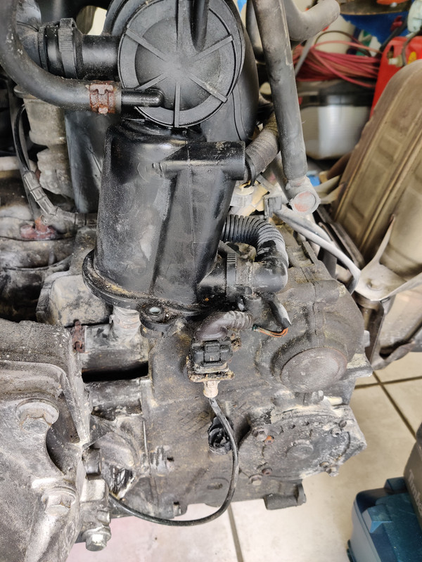

I am repairing the 996 Targa of my old man to make it reliable again. It has been leaking coolant and oil, so I identified the main problem to be the AOS. Changing it didn't go well because a previous workshop had over torqued and stripped out one of the AOS screws
Therefore, the engine had to came out, and I am doing preventive maintenance as working on the engine while it's in the car is a PITA. I need your knowledge and expertise on what makes sense to replace and what is not necessary. The car has 130000*km (ca. 80000 miles).

- timing chain guides: Reasonable or overkill?

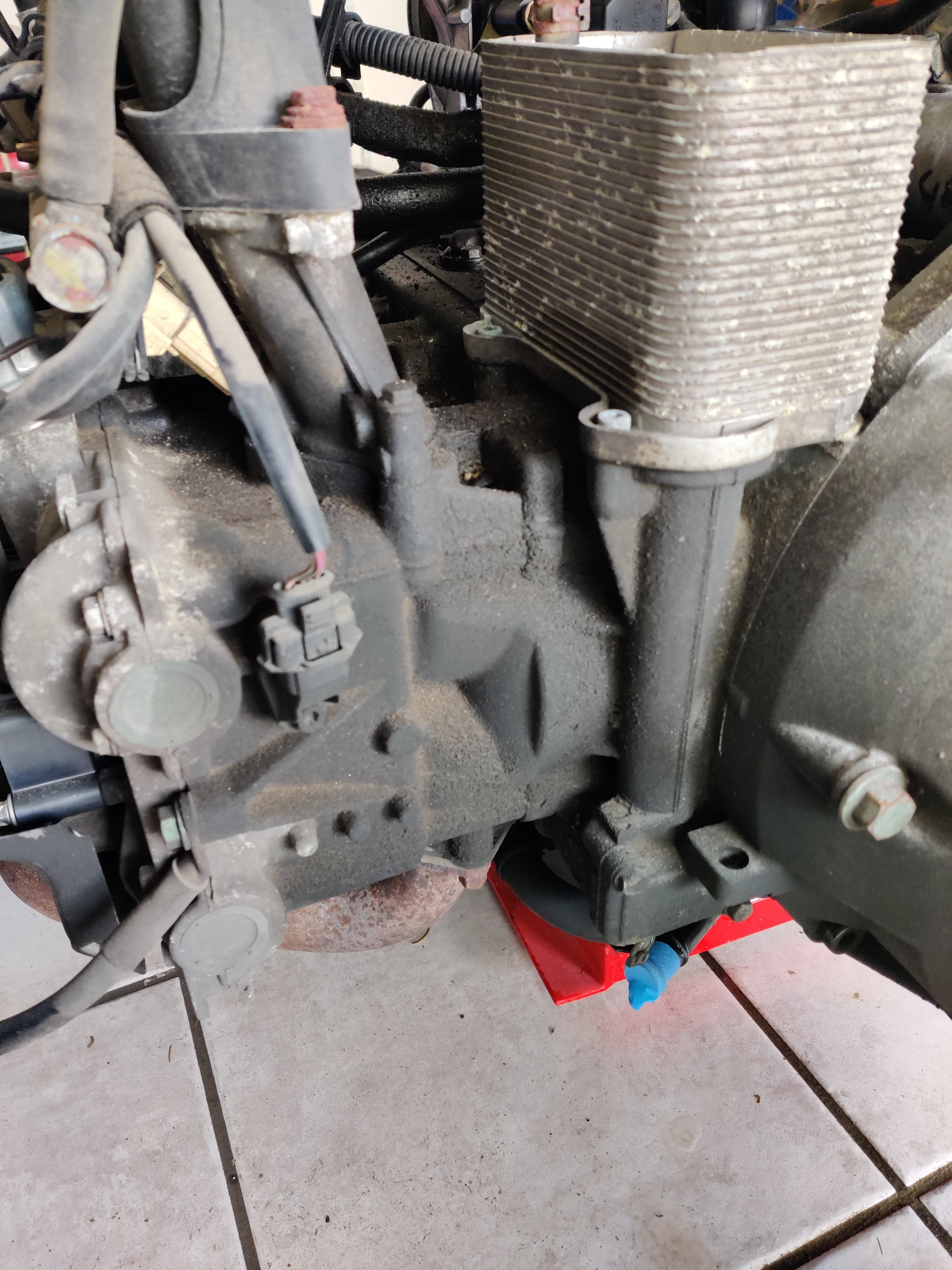

- oil cooler: Reasonable or overkill? Original one doesnt seem to leak and looks okay. See pictures below

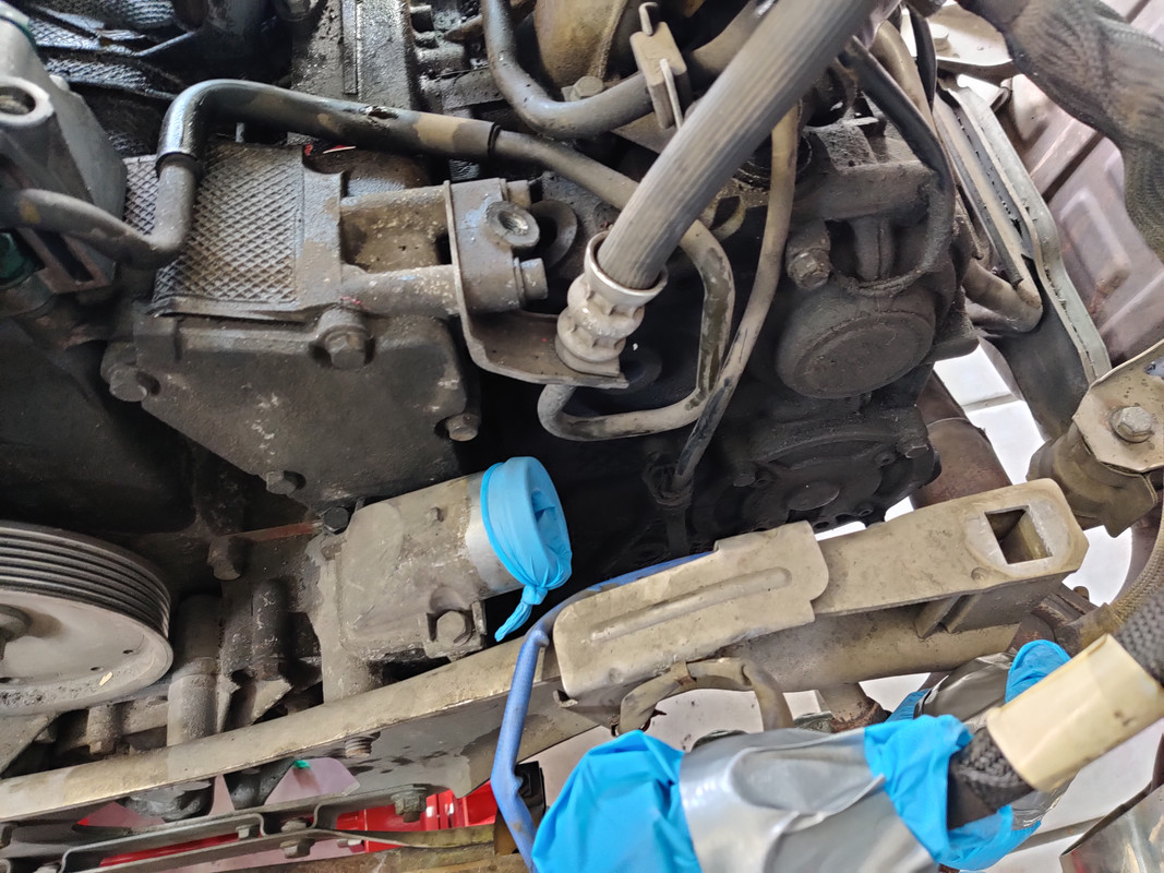

- shift cable: The ends are rusted, also the clip holders are broken off. Could get cheap some from a Porsche 996 Turbo. Do they also fit the naturally aspirated engine?
The engine was very oily from the outside. I know I'll never get the engine completely dry, but I'd like to at least try. Can you tell from the pictures where the leaks are coming from? I would then simply replace the relevant seals as well.

Replace the plastic coolant tank . So much easier with the engine out . Have the alternator tested . Replace the o-rings on the oil cooler.

Replace the starter alternator cable. It corrodes over time and makes it appear you have an alternator or battery problem or both. There are 16 coolant hoses around the engine. Examine them all.
