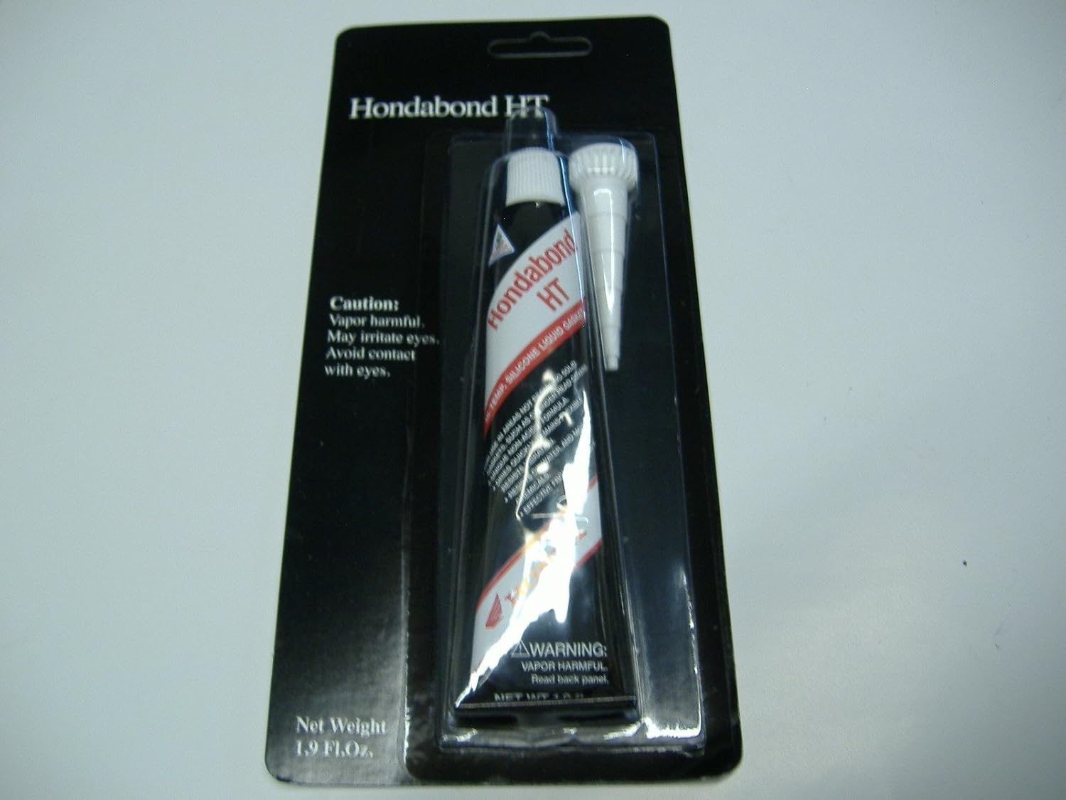

FWLIW and YMMV...
I centered the bearing as best I could and covered the torn rubber ring in Honda high temp gasket sealer about three months ago.
Rather unPorsche-like and unconventional but it's worked great (so far) and for $13USD and about 30 minutes work, a pretty good temp solution at least.
If your bearing rubber gasket has yet to tear, I would surely cover (lightly) with this and it may last forever. (No guarantees) If your rubber part is completely gone, this repair will not be feasible since you need that substrate for the Honda gue to adhere to.
