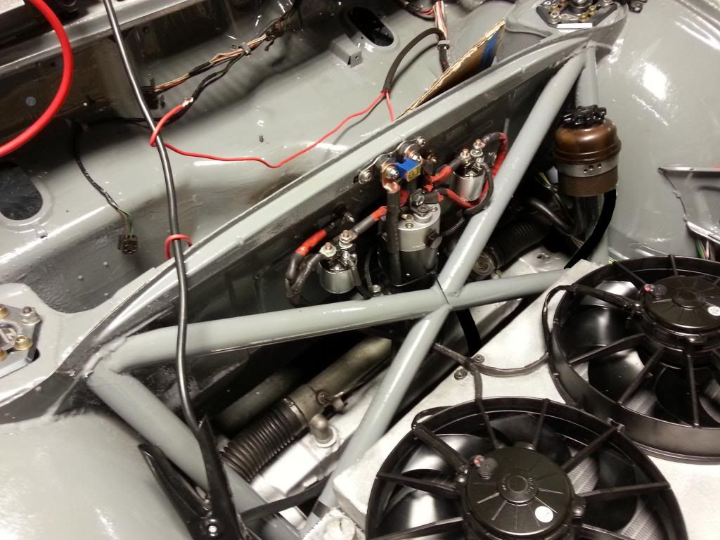

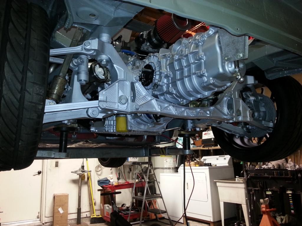

I'm not doing a rear radiator or a 911 for that matter. You pose a great question, given we would like to be able to run at 4k all day with out issues. I'm not done with my car as yet ( 914, 2000 corvette LS6, 996 suspension, G-50-5 speed) but using an extra radiator is in my back up plan as well. I'm using a 2 pass radiator 1 1/4" / 1 1/2" coolant lines with a 55 gallon per hour pump and 2 two thousand CFM fans along with a 200 amp alternator.

I have done a 944 conversion with a ls4 5.3l as a mid engine and the original radiator drove for over 10 minutes up a grade for 3+ miles and down again no over heating problem don't know the rpm

What kind of RPM were you at? What is the size of your radiator? Any pictures of your build?

Porsche Crest 944 mid
here are a few photos,radiator stock 944 with stock fans, no info on rpm (not the latest photos)

Any pictures of your radiator? That is an amazing build.
