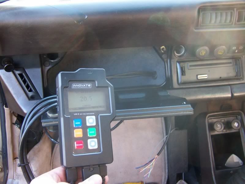

I'm running the LM-1 wired in the car, I have a 100psi Pressure Transducer, RPM, O2 sensor, and 3 Bar MAP. I used the LM2-A which is the Innovate RPM aux cable for all the inputs. I also added a Greddy Boost Controller, an AFR display, and a MSD 6AL-2 programmable ignition. I put a mounting plate under the pass. seat and tied everything together there. The one thing that was stressed for all these additions was a good ground. I ran a seperate ground wire from the neg. batt. terminal to a mounting plate ground bar and then to the rear chassis ground lug behind the fuel filter. This way all the different components are grounded to the Neg. Batt treminal and all the signals are very clean. My engine is out so I haven't been able to do any programming yet but I can find all the inputs on the LM-1. I would stress that direct ground connection to make sure all the devices have a direct ground path.
Brian: I got the wastegates torn down and one diaphram had a small hole. The other 2 are good. If you need a diaphram for your car I'll send my spare, if you were just looking for a spare I'd rather keep it. I have 2 springs to send you I believe one is 1.0 and the other is stock. I couldn't check them so I can't say that is exactly correct. Let me know on the diaphram, if it's to get you going it's yours. Here are some pics.of the install: ![]() ![]() ![]() ![]() Cole

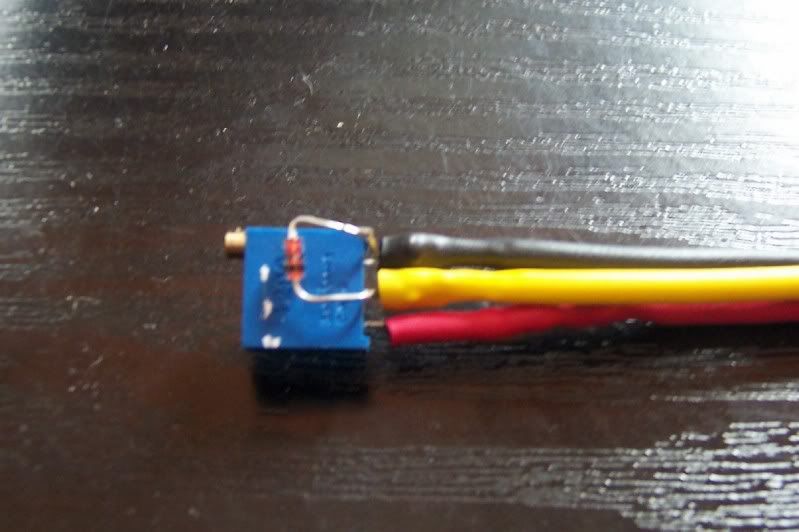

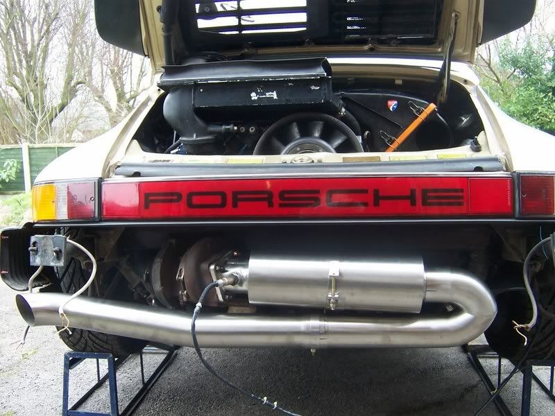

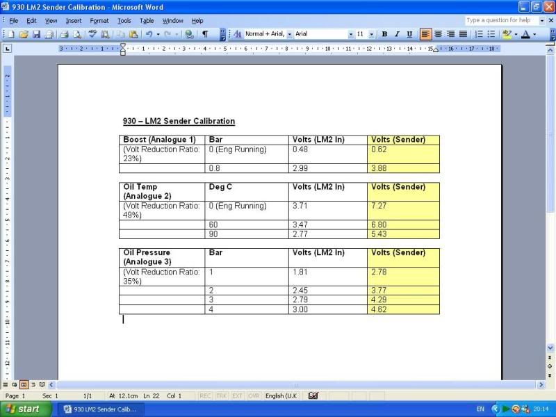

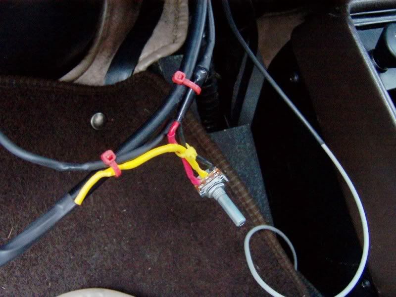

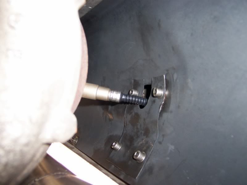

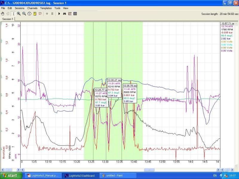

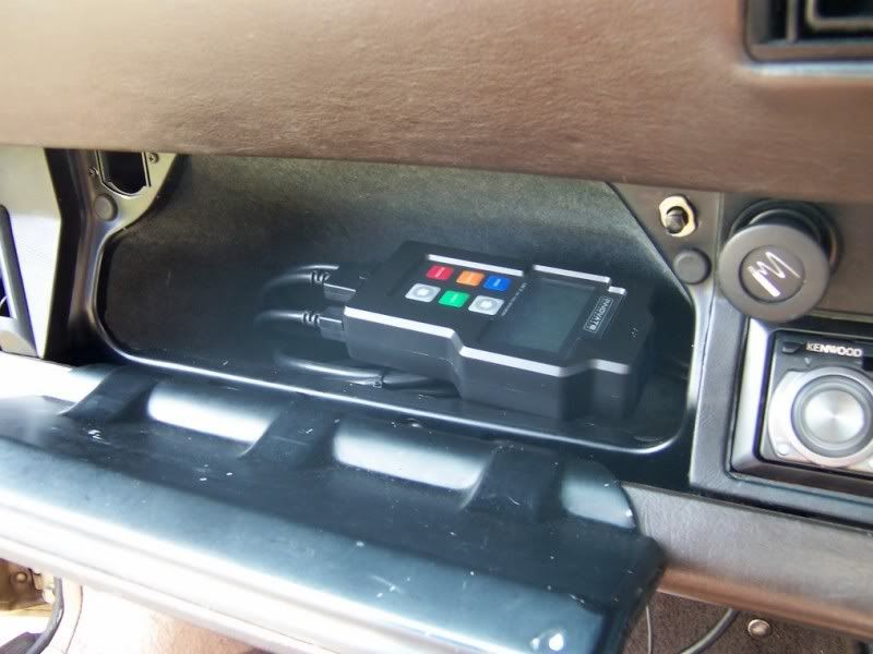

I installed an LM-2 a while back and log AFR, RPM, Boost, Oil Pressure and Oil Temperature. It’s not “plug and play” as you need to get a very clean RPM feed and also reduce the signal voltages on the other sensors. I used the stock boost sensor and it works fine, although it's obviously reading boost before the throttle plate so gives a slightly different reading to my mechanical guage. The LM-2 has generally been fine but does freeze occasionally. I used an 18ft cable and have the unit in the glovebox.
![]() ![]() For RPM I started by trying to use the tach signal out of the CDI (Blk & Violet) but this was useless and so in the end I hooked it up straight to the coil (-ve terminal). This produced a very random & unstable reading so I used miniature co-axial cable with a steel shield (earthed at either end) to clean it and then smoothed it by running the signal into the LM-2 through a 1M potentiometer, acting as a voltage divider. By tuning the pot you can damp out the spikes leaving a stable output. You need to configure the LM-2 in the relevant sub-menu; settings aren’t very clear but the ones I’m using are: • Falling edge (you have a choice of rising or falling edge on the configuration menu.) • Cal 6 – 3 pulses per cycle (you have around half a dozen choices to configure to different numbers of cylinders). The three potentiometer terminals are connected up as follows: • The two outer ones go to ground (same place as the earth for the LM-2 power supply) and to the tach signal (from co-ax) respectively. Doesn’t matter which way round. • The middle terminal goes to the LM-2 analogue feed (RPM +ve Blk/Wht) • The co-ax shield goes to the common earth and the LM-2 RPM –ve input (Blue) also goes to common earth. Mine looks like this: ![]() The AFR signal was straight forward: ![]() ![]() ![]() I took signals from the sensors for boost, temperature and pressure into the available analogue inputs on the LM-2. The difficulty is that the LM-2 can only accept a 0-5V input so it’s necessary to reduce voltages. I used a 10K pre-set potentiometer for each signal, a 5.1V 0.5W Zenner diode on the output to the LM2 (between output & earth) to protect it from any spikes above 5V and also a 1K 0.6W resistor in series on the input to the pot. I simply followed a diagram in the LM-2 manual. It's then just a matter of setting the pot to give the right ratio reduction; in my case 49% reduced for temp and 36% for oil. Here's what the reducer looked like: ![]() Calibration data that I used is as below: ![]() Here’s a screen shot of data in logworks: ![]() Good luck & hope this helps. David
David 1984 ROW 930 - Stock except Rarlyl8 1-out, Andial IC, Air Pump delete, Carrera & Setrab Coolers, 0.8bar & LM-2 |

Very nice setup David.
I built a separate 5vdc power supply from about $8.00 in Radio Shack parts that works very well. It's the black box on the mounting plate under the Pass seat. If anyone is in need of one I have a schematic and parts list. I also found a lot of help from the Innovate Forums on their web site. They do a great question answer type interaction with an Innovate Tech and it's good real world application stuff that addresses a lot of the common issues. Cole

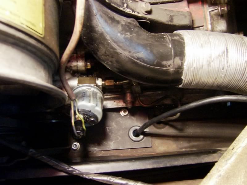

How are you all getting the cables inside the vehicle? Using the shifter tunnel? Did you make an extra hole on the outside that still comes into the shifter tunnel? Any pics of this?
1979 SC, Slant nose wide-body cab conversion. AEM Infinity EFI, COP, supercharged! |
Join Date: Jul 2006
Location: S. Florida
Posts: 7,249
Don't know if a '79 is the same nut on an '87 there is a rubber plug/grommet in a hole just above the floor pan down behind the driver seat.
Thats where I ran the Innovate LC-1 and MSD 8762 wires into my car, and then on up along the edge of the center tunnel under the the seats and under the carpet. Here's pic of it with a red arrow pointing at it.
