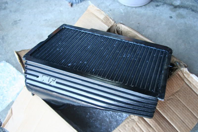

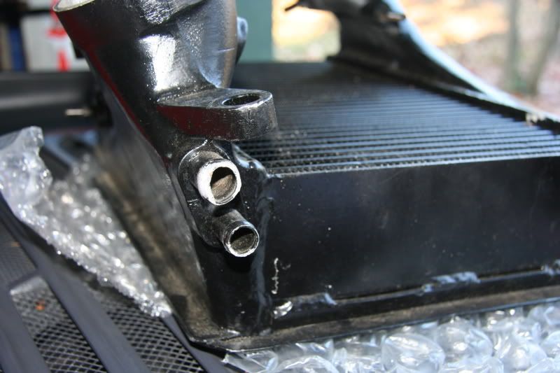

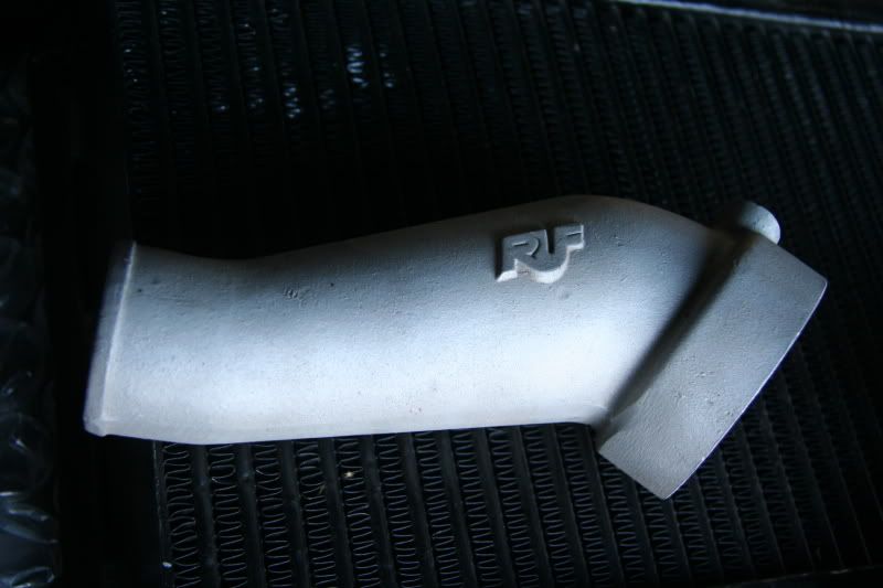

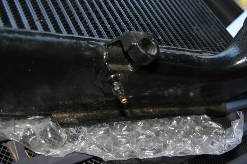

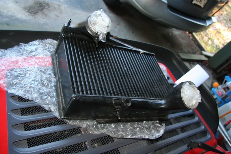

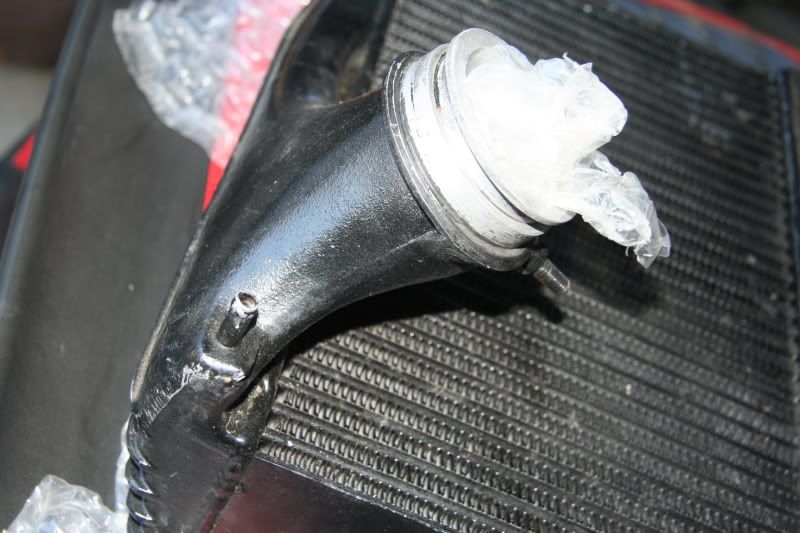

pics:
I could use help on identifying all the smaller outlet/inlet tubes, how relevant that one partially crushed one is, and any other details that might help. Thanks!

Review the link below:
http://members.rennlist.org/magisterc/kokeln.html
The two "tubes" connect to the recirc valve which attaches to the new rubber elbow and to the Auxillary air valve (AAV). Shouldn't matter which orientation.
You will also need a piece of aluminum tube 5" long that is 3" at one end and 2 3/4 " at the other for connecting the new rubber elbow with the stock intake tube. I used a piece of 3" aluminum tube with a 3" to 2 3/4 silicon reducer on my C2 intercooler install.
I would attempt to fix the partially crushed tube. A steel rod and hammer lightly tapping should allow you to work that out.

The RUF tube in your picture replaces the factory boost tube which connects your turbo to the intercooler. The 5" piece of aluminum tubing replaces the factory diverter assembly which occupies the space between the factory elbow and the air intake pipe which attaches to the turbo compressor. You can do as I did and purchase a silicon reducer ( http://cgi.ebay.com/ebaymotors/_Car-Truck-Parts-Accessories__3-0-to-2-75-Silicone-silicon-reducer-coupler-black_W0QQitemZ310102944232QQadiZ2865QQadnZCarQ20Q 26Q20TruckQ20PartsQ20Q26Q20AccessoriesQQcmdZViewIt emQQptZMotors_Car_Truck_Parts_Accessories?hash=ite m310102944232&_trksid=p4506.c0.m245&_trkparms=72%3A543%7C65%3A12%7C39%3A1%7C240%3A1318 ) OR go the Sandman route wherein you get a muffler shop to expand the end of a 2.75 inch pipe to 3".
This is sandmans thread : http://forums.pelicanparts.com/showthread.php?t=366674&highlight=intercooler+sandman
If you review it in conjunction with the above it should all make sense. Let us know if you have any other questions.

Hello vmb,
I am doing the same currently, maybe I am 2 steps more close to the final.
If the pictures show all your hardware, for sure you need some more stuff.
1: The rubber fittings from your OE intercooler with the small metall tube inside,
I guess you have them.
2: 2 spacer tubes, approx 100mm long, I can measure later for you.
3: 1 stud M8 approx 120mm, you can get in any hardware shop.
4: connection sheet to fix your RUF iC inlet on the IC, nothing special.
5: barn door outlet to turbo inlet tube... here you can go different routes.
I would use the 930 rubber bow, a aluminium reducer pipe with welded
on fitting for bypass valve.
2nd choice, buy the 965 rubber bow which has the bypass connection and
use a aluminium reducer pipe.
I can offer to build the 2 spacers and the aluminium reducer pipe for you,
I need to build 1 set for me anyway, all on self costs + shipping.
Only I cant do this fast, I may need time for this.
Or I can send you the drawings when they are ready.
*+ the angled fixing which screws on the coil support, check this carefully.
mine was not fitting and I needed to cut it and reweld it.

one big difference between the Porsche and the Ruf IC is, the RUF is a so called "longneck" IC.
That means you need to remove your bypass housing.
On first view maybe you dont want to touch it, but its not that big deal.
The bypass/BOV housing is located under your original IC, above the throttle body.
When I say spacer, its only because I don`t know a better english word,
its a thickwall tube, approx 100mm long, maybe its a distancer.
After removing that housing, you will have the right "spacer" left.

*remember to "ground" the RUF IC!! The overboost switch is screwed in there,
at least at mine. Without ground for the switch, your car won`t start.
Falk

the "spacers" being referred to are part of the actual hardware which fastens the intercooler down. I neglected to mention these as my installation of the C2 intercooler entailed different mounting options. The "connection sheet" referred to is the mechanical means of fastening the intercooler to the boost tube so that under boost they do not come apart resulting in an intake leak. When looking at the intercooler you will notice a stud protruding right above the point where the boost tube attaches. On the boost tube you will notice a threaded boss. When attached together - inline - the "connection sheet" with the two holes attaches these together. One hole over the stud then fastened with a nut, the other over the threaded boss with a bolt and washer securing same.
In the photo above you can see where the intercooler is fastened to an aluminum "tube". This is one of the "spacers" being referred to.
