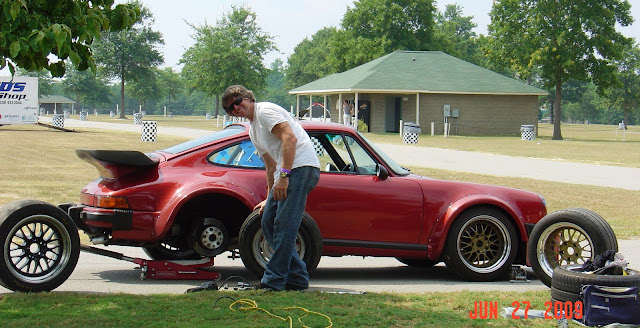

Glad it all worked out for you, that can be a very dangerous situation.
This (pictured below) happened to me on a 500 mile trip at 80mph on the interstate in heavy traffic. I picked up something on the road and the left rear went down real quick. The wheel cut the sidewalls down by the time I could get it hauled over to the shoulder. The most frightening part was changing the tire while 18 wheelers blew buy at full speed less than 5 feet from me.
Needless to say my can of fix-a-flat didn't do much good, ha!
