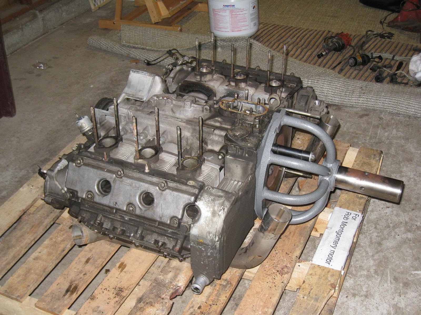

Motor arrived yesterday morning. Unfortunately without a cherry picker, or a couple of extra bodies on hand, I was stuck leaving the motor on the pallet for the time being. Anxious to get a jump start I went to work removing the CIS injection system, wiring harness, engine tins / shroud and fan.
One thing I ran into on a couple of the hard oil lines was that the fittings that attached to the engine seemed to have been locked up. I was always under the impression that the intended design allowed you to spin the fastener while keeping the hard line stationary. two different fittings were locked up to the point where I had to detach the opposing end of the line and then spin the entire piece to remove it from the engine. Is there something I can soak these in before re-installing so that they work as intended?

the connection is very close to the bend in the tube and just a little out of round will make it hard to spin. put a rag around it and very carefully squeeze it to make it round that should do it but be careful if you go to much or the wrong way it could be a mess and you could end up needing a new line good judgement must take place!!
