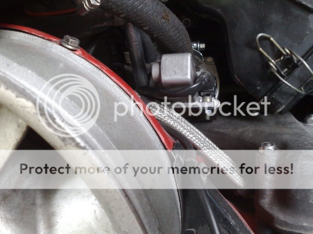

I think I have the answer - it's none of the things suggested.
I'll take a picture, but it's the part which has a pipe down from the right side of the Intercooler.
My local specialist identified this part as the problem (he's seen it in other old 930s), but he doesn't necessarily have the skills to take this thing apart and recondition it himself. (Have a suspicion that, after 30-odd years, the bimetalic strips inside will be failing.)
Todd informs me that this is known as the 'Auxiliary Air Regulator'

Fixed! (Or at least I think it is. )
Thanks a lot, Todd - have to see if the fuel consumption improves any now - it was the AAR (and not the cable / linkage catching on anything).
