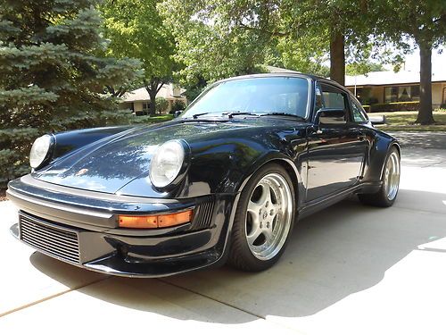

I owned a 1979 911 which I loved, but sold it in 1986 in my quest for more power. Now I'm back and just scored a 38k mile 1986 930 with a Ruf conversion. In a complete moment of lust, I bought the car flew out to the owner and drove it 600 miles home. It's a real beauty and performed flawlessly other than the a/c not really working. This is a one owner stock Ruf conversion that has been taken care of with no rain or snow. If it was yours, what improvements would you make?

Not enough info. What was done in the conversion, and what are your goals?

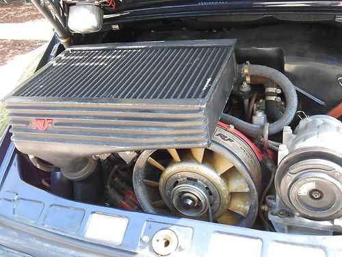

K27 turbo, intercooler, heads, cams, tensioners, gauges, front valance with oil cooler, exhaust and headers are the main upgrades. My goal is a solid daily driver with plenty of go!

Your setup sounds very good. Any idea which K27 you have? There are many different ones as the 7006, 7200 HFS... Have you run the car hard and does it run out of steam before redline? If so, you could change the turbo. My K29 pulls hard from 3k to redline+. However, it is a dinosaur and there is much newer technology around.
Not sure where you live, but if it is a daily driver, you probably want ac. Start with upgrading that with products from Kuehl or Rennaire. Porsche 911 Air Conditioning, Porsche 930 Air ConditioningUpgrade Updates,Improvements One thing really lacking in our cars is the ac. They can be made cool, but the volume of air really needs to be upgraded. I swear, the ac on it's highest fan setting is like the lowest setting on my Lexus.

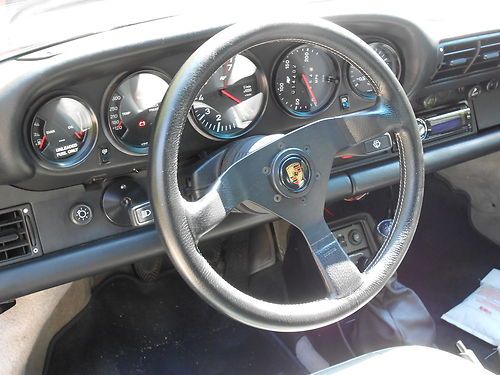

You can also add personal touches to your car such as a new steering wheel, bit I think your car may have a Ruf 3 spoke which is every similar to the 930S wheel. You can however, get a spacer to place it closer to you/farther away from the dash. You can also change seats to something more sporty, a nice stereo, wheels/tires, torsion bars... Those personal touches truly make it your car.

It really depends what the set up is, if it's still on CIS then a better turbo, then tune in the fuel system with the adjustable WUR and solenoid.
I would want to keep it as Ruf did it though, as that is where the value is in the car..... if you don't care about the 'Ruf' originality then it's all down to how deep your pockets are and how much power you want......
We need pics, what headers, what gearbox etc etc.... How much Ruf work was done, if it's a fully badged up BTR type car, with all the Ruf bits then it would want to be kept as close to as it left Ruf as possible IMO.....

Okay, okay, no pics it didn't happen, right?
These are from the original owner. I am travelling (too much) and won't see the car for a while.
