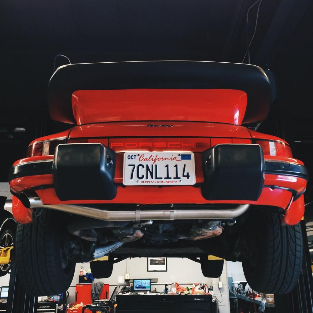

OK OK here are some photos, no ban please! I have just received a new piece of rubber for the whale tail, a new temp switch that kicks on at 210 and a classic WEVO shift assembly is on the way. I can tell this car is going to burn some holes in my pockets.

Great looking car! Looks like you might have one of Rarelyl8's exhaust systems…any info on those wheels?? 17's? Hard to tell from he phone. Welcome!
