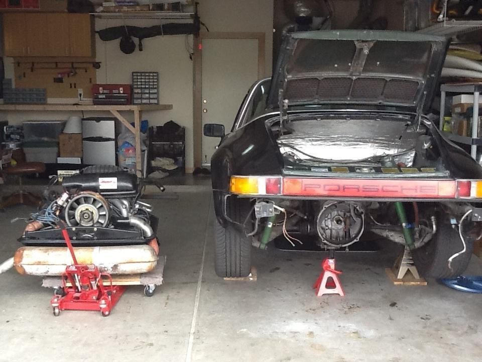

Hello fellow pelicans,
After 5 years and 25,000 miles on my first rebuild, I have to open her up again, for a rod bearing failure, most likely #2. This happened due to oil starvation, when one of the oil hoses got disconnectd due to a shoddy installation on my part...Thankfully, I did not split the case the first time, only did a top end, so now is a perfect opportunity to refresh the bottom end. The compression was good, heads are still fresh, headstuds were replaced last time, so I am hoping only the bottom end will have to be done, but I will only know for sure when I dig inside. Stay tuned.
Here is the patient, 78SC with 129,601 miles.
1978 SC Targa, DC15 cams, 9.3:1 cr, backdated heat, sport exhaust https://1978sctarga.car.blog/

The symptoms were a noise that first could have been mistaken to a valvetrain noise.
http://forums.pelicanparts.com/911-engine-rebuilding-forum/684493-does-sound-like-rod-knock.html
But the last time I went for a drive, this noise turned into a very loud knocking, the kind of noise that makes you turn the engine off ASAP. Then I found little bits of metal in the oil.
The hose that caused the starvation is a rubber hose I needed for backdated exhaust. Big mistake. I should have kept my old exhaust...

I did not install the corrsover oil line, instead used my old one wich I cut and connected to the rubber oil line with a hose clamp. The connection eventually gave. Very very stupid idea on my part. My advice: Do not try to save money on these parts.

I have been using a 1000 pound harbor freight hydraulic table to both drop the engine and raise it to the P201. I like this better than the ATV jack which didn't have the vertical reach or the "stack of wooden blocks on the 21" rise floor jack" which I just didn't trust.

For my drop, I used the "small drop" method, i.e., I kept the car only high enough so that I could loosen the tranny mount bolts, then used the floor jack to ease the engine down onto a rolling cart - about 3" - then jacked the car up slowly until there was enough clearance to roll the powertrain out.
I used a come-along attached to a strong point in my garage ceiling to lift the engine up onto the engine stand. The come-along is rated to nearly double the engine weight, but let's just say I didn't leave her swinging for very long before I got the weight onto the stand.
