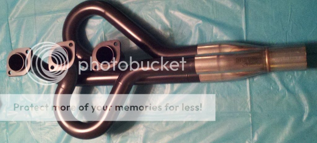

So here is an example. The difference between the blue and the white arrows is not insignificant.
Which one determines actual primary length for the purposes of header design?

You want to measure from the exhaust valve all the way to the where the blue arrow points.

Just like winders said, measuring the length along the centre point of the tube as you move along.

ok. So the blue arrow is where there appears to be total termination of the primary and it defines the end.
I hadn't thought to include the distance to the exhaust valve. What's that, 1-2 inches on top of the apparent primary length in the headers themselves?

The resonance and restriction is going to be affected by all the bends and transitions so it's not quite as simple as a mean path length but I'd say that should get you in the ballpark (red line).

The header length calculations are just not that accurate. PipeMax can get you very close but still not 100%. Build it as short as possible with a few pipe diameters straight before the collector. Then build 3" extensions for testing on the dyno.
I built this for a 914-6 project some time ago, collectors are by Burns. The 3" extension clipped off 400 RPM at the top and was not a good trade off for the build.

I like these guys better than Burns:
Exhaust Components - SPD Home Page B
They offer a 12 degree merge collector which I don't think Burns does. They have everything you need to make 911 headers.
I would not build primaries as short as possible. That will get you a peaky engine which is not usually what you want even for a race car.
After the merge collector, which should have an output smaller than what I see in the photo, you want to transition to the final outlet size. A 7 degree transition is good. The transition gives some restriction which is good.
