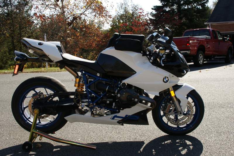

Here is a shot of #46 with a Garmin 376c and an old RKA tank bag that has plenty of room and works like a charm.

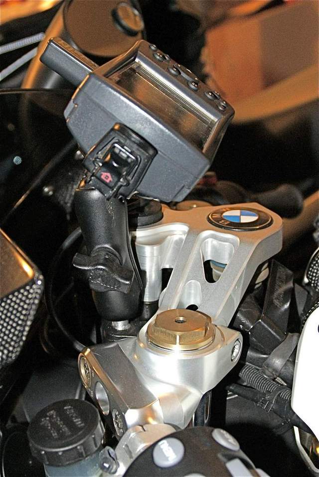

As to the GPS mount, I'll take some pictures, perhaps this evening. As it happens it was very simple. I'm not a big fan of clamps and had a RAM mount with a ball on the base for the Garmin 376c.
The top triple clamp has a hole already drilled and tapped that I used to attach a RAM ball to. As I recall the hole is on the underside of the top triple clamp on the left (seated on the bike) side. It is not obvious and is a bit out of sight. I stumbled on it when I was trying to figure a way to do a clean installation. No idea what it was intended for.
I have included the best picture I have on the laptop but will try to get a better one. The RAM mount was the RAM-11M available many places or try Cylegadgets.com. I had an appropriately sized bolt in my tool box.

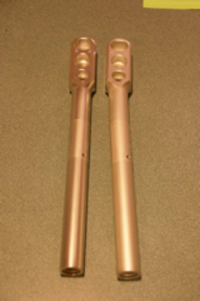

Also included is a picture of the left handle bar that I bent last June when I hit the deer. I shot it (the bar not the deer, which hopefully died a slow death of starvation from a broken jaw) alongside the replacement which just arrived last week...($200). That and the left front turn signal lens were the only damaged parts...other than my fingers. I was damn lucky.

FYI, I used the same tapped hole for my radar detector's mount.

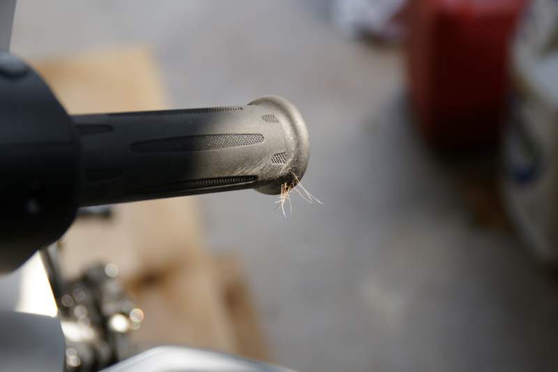

Here's a picture of the left grip after I got home...yep, deer hair! http://forums.pelicanparts.com/uploa...1226432878.jpg

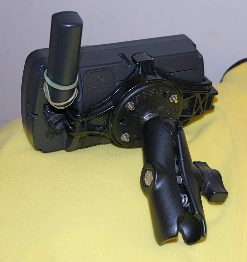

GPS Mount Using RAM Ball On Triple Clamp
Here are a couple more pictures of the mount. The GPS is a Garmin 376c.
