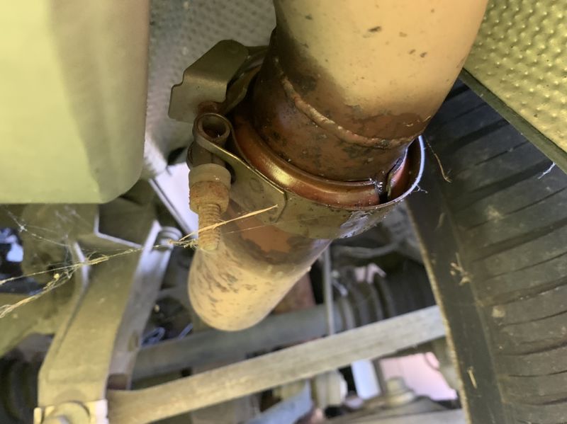

The V bands before the mufflers clearly have some oil soakage. With it idling and the engine cover off, smokes was coming up from the compartment.

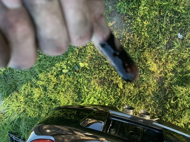

I ordered a new seperator, and I plan to do a compression/leak down test. I just wonder if the catalytic converters and mufflers are oil soaked causing this to continue. I’ll include some pictures of my finger tips after wiping the exhaust tips.

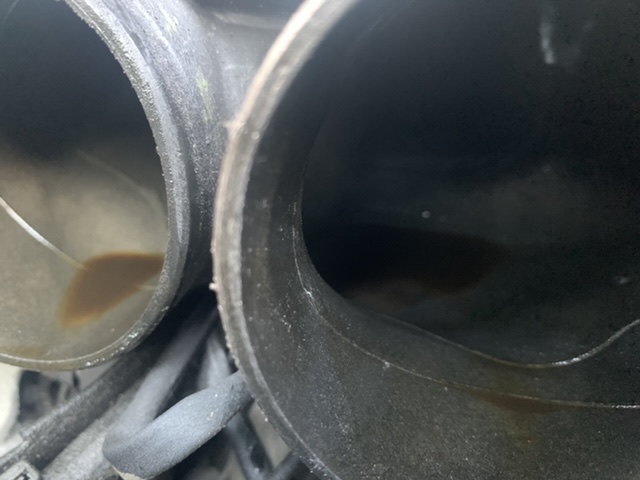

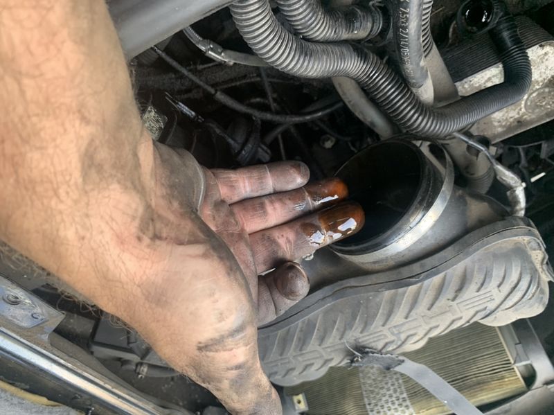

I pulled the intake plenum and AOS. I am almost positive that’s the problem.

Got everything cleaned up and replaced, fixed the problem! Now to tackle the non existent 2nd gear.
