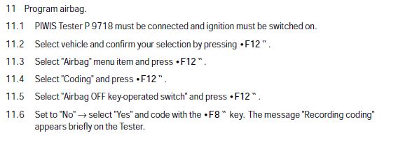

Hmm, the Durametric enthusiast as well as the iCarScan X431 would reset the airbag light. It sounds like only the Durametric Pro would allow the programming change for the switch. How about the iCarScan. I wouldn't think so, but it's a bit light on documentation.
I've got two great shops nearby that I can probably take the car to, although I would love to be able to reset lights myself.

I could turn the airbag light off for you with the X431. Not sure about changing the coding (probably not, see below). PM me if you want to meet up.
Changing coding on the Benz is easy - - the app gives you the options and you select which one you want. On the Porsches, however, the coding options are not specified/explained by the app, but rather are a mystery box to which you send a string of digits. Some of these codes can be found on the forums (RL) if you do some digging, but in general, coding sketches me out - - I'd prefer not to do any harm by accidentally sending an incorrect code.
Ah, gotcha, absolutely. Thanks, I'll give Matt's battery trick a shot. Then I'll probably go to Modern Air Cooled or Einars for the coding since I need the switch to work.

Glenn, I would just go with the Durametric Enthusiast. I have the Durametric Pro and there's not much it won't do. It's a little expensive but if it saves you one dealer visit in the future, you've gotten your money's worth.

Also, Steve, I looked into the coding for Porsche 9X7s. See this site for info:
https://rennlist.com/forums/997-forum/896181-making-a-durametric-coding-options-manual.html
It looks like coding on the 9X7s is simpler than for the 955/957 Cayennes, which use a more complicated VW architecture (with codes that use multiple digits/bits). That said, I couldn't figure out what exactly you were trying to code.

Apparently, once you install one of these
You also have to do this (it seems like they would have things set so that once it was installed it did something)
But the good news is that now we should be fully prepped for the grandson now. We've been OK so far, using the seatbelt (which is recommended for when they are heavier, so should work ok with him being lighter) and since he's light enough, the airbag is off due to him not tripping the weight sensor, but it is still nice to have things as they should be (once I get the computer programmed).
