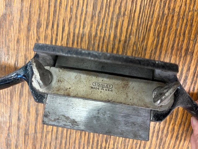

look 171 03-11-2024 04:07 PM
Hey Steve, I found it. You still want a Stanley No. 8 cabinet scarper? Get me me your address again.http://forums.pelicanparts.com/uploa...1710198407.jpg

MBAtarga 03-11-2024 04:16 PM
Instruction sheet for above scraper - one of which I own:

Nice thanks.
I think pretty much anything will work as a burnisher, right? Probably even a screwdriver or ratchet extension.
I've got a steel for kitchen knives, that would probably work as well, I think.

I've used a smooth screwdriver shank and also I've got an old valve stem. Anything that would be hardened - and preferably smooth. Socket extension would be fine.

I just use a screw driver. It still pretty sharp after all these years sitting in those old boxes in my shop.

Your kitchen steel likely has mini groves. To roll a burr you need a very smooth round object. Shiny smooth. I don't go to the 75º extreme. I just start level and make 3-4 passes to about 30 degrees. If you are clever you can make a burr on both sides and flip the thing over when needed. That way you have 4 edges before rolling the burr again. Every other or 3 rd time you should use the file to square up the edge for new burrs.
New wood a burr might last a long time. Using it to remove finish and the burr can go away in a few scrapes. It pays to buy good scrapers. One I have is from a restaurant supply and used on griddles. It's very stiff so the corners could dig in. The thinnest in the kit is about a 16th. You can flex that to scrape just an inch wide path.

Our Steel is round, but only has the ridges that you mention on half and is smooth on the other half (kind of weird and unusual, I know).
Zeke 03-12-2024 02:08 PM
Then it's good.

I often use a utility knife blade. Works great. For larger surface, I just use my random orbital sander and step down in grit. Of course, with a glass of wine on one hand and a cig. on the other.
