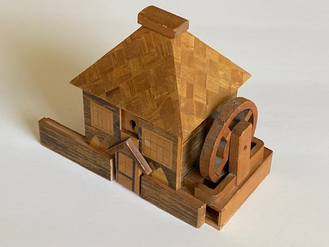

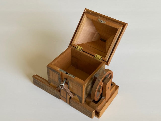

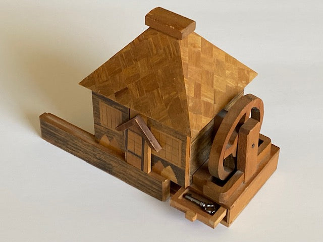

masraum 06-04-2024 02:56 PM
Originally Posted by stealthn (Post 12260618)
This one will blow your mind, well worth the watch - puzzle boxes
<iframe width="1280" height="720" src="https://www.youtube.com/embed/_NreYBwzRQk?si=G67Ag_MalVrr7DR4" title="YouTube video player" frameborder="0" allow="accelerometer; autoplay; clipboard-write; encrypted-media; gyroscope; picture-in-picture; web-share" referrerpolicy="strict-origin-when-cross-origin" allowfullscreen></iframe>
Holy CARP!
When I was a kid living in Japan, I got a couple of puzzle boxes, but wow, nothing like what he makes.
THey are pricey, but wow, dare I say, worth it if you have the spare dough to spend on something that marvelous.
https://www.kagensound.com/page5.html
These aren't mine, but are VERY similar
https://puzzleboxworld.com/cdn/shop/...g?v=1564355147
Actually, this one appears to be EXACTLY like one of mine.
https://puzzleboxworld.com/cdn/shop/...g?v=1629922609
https://puzzleboxworld.com/cdn/shop/...g?v=1629922614
https://puzzleboxworld.com/cdn/shop/...g?v=1629922618
https://puzzleboxworld.com/cdn/shop/...g?v=1629922622

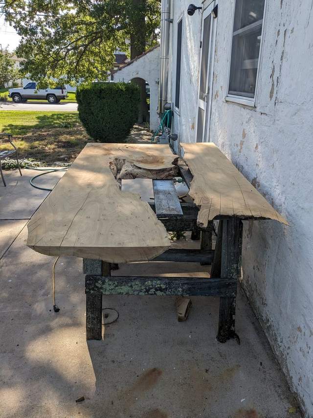

After a bit of a hiatus, I'm back doing the live edge, and river tables.. Recently I started an Etsy account to see if I can monetize this.. everything I've made to date has been gifted to the girlfriend and relatives.. My brother just asked me to do a bar top in his den.. that will be done for just material costs..
I dragged a big ass piece of elm outside to trim reshape, and dress the edges
$800 worth of elm..
http://forums.pelicanparts.com/uploa...1717624135.jpg
General idea for the table
http://forums.pelicanparts.com/uploa...1717623800.jpg
Dressed up the edges
http://forums.pelicanparts.com/uploa...1717623877.jpg
This one is going to take a lot of resin and pigment probably north of $1500, depending which resin I use the cost is $130/200 per gallon

Wow!

Table will be roughly 44X72... I think It will make an interesting dining room table

That's going to be cool table. $800. for the slab? Yikes.
I made a similar resin table years ago and poured over a 12v LED light string. It turned out pretty cool but a little '70s cheesy.

So it's going to be a small table. :D
Big tables often have aprons and occasionally stretchers. How are you going to design the support structure and how do you attach the top and base?

That will look very cool. Are you going to put some more wood “islands” in the voids or will it be all epoxy?
