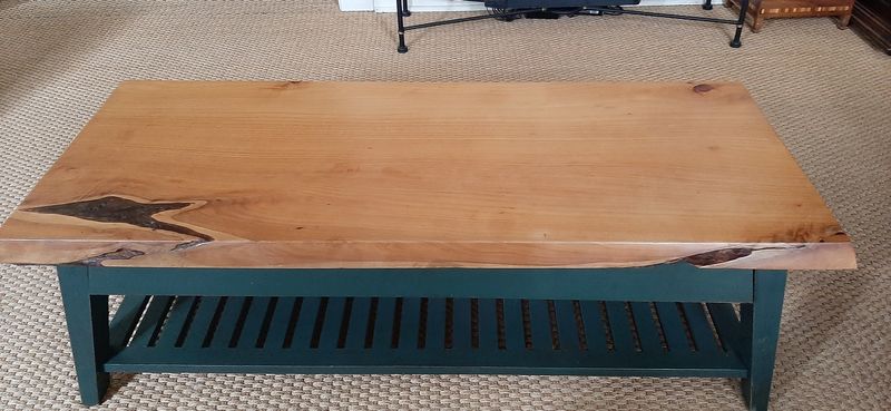

You can make an interesting table with a boring top by focusing on the base. I made this coffee table several years ago using a slab of Cypress. I bought it from a different buddy who sells all kinds of slab. I think I paid $180 for it. I made tapered and angled legs, a blanket shelf, a 4' wide drawer and color. First bronze paint then watered down forest green and did a rub through on the corners. Since I wanted the focus to be on the base I cut the live edge of the slab off on the table saw at 22°

That is lovely, and not at all boring.
gregpark 06-05-2024 09:52 PM
Thanks. This is in my living room, I kept this one. The legs are laminated maple, the shelf is poplar-kreg jigged and the drawer ½" birch ply

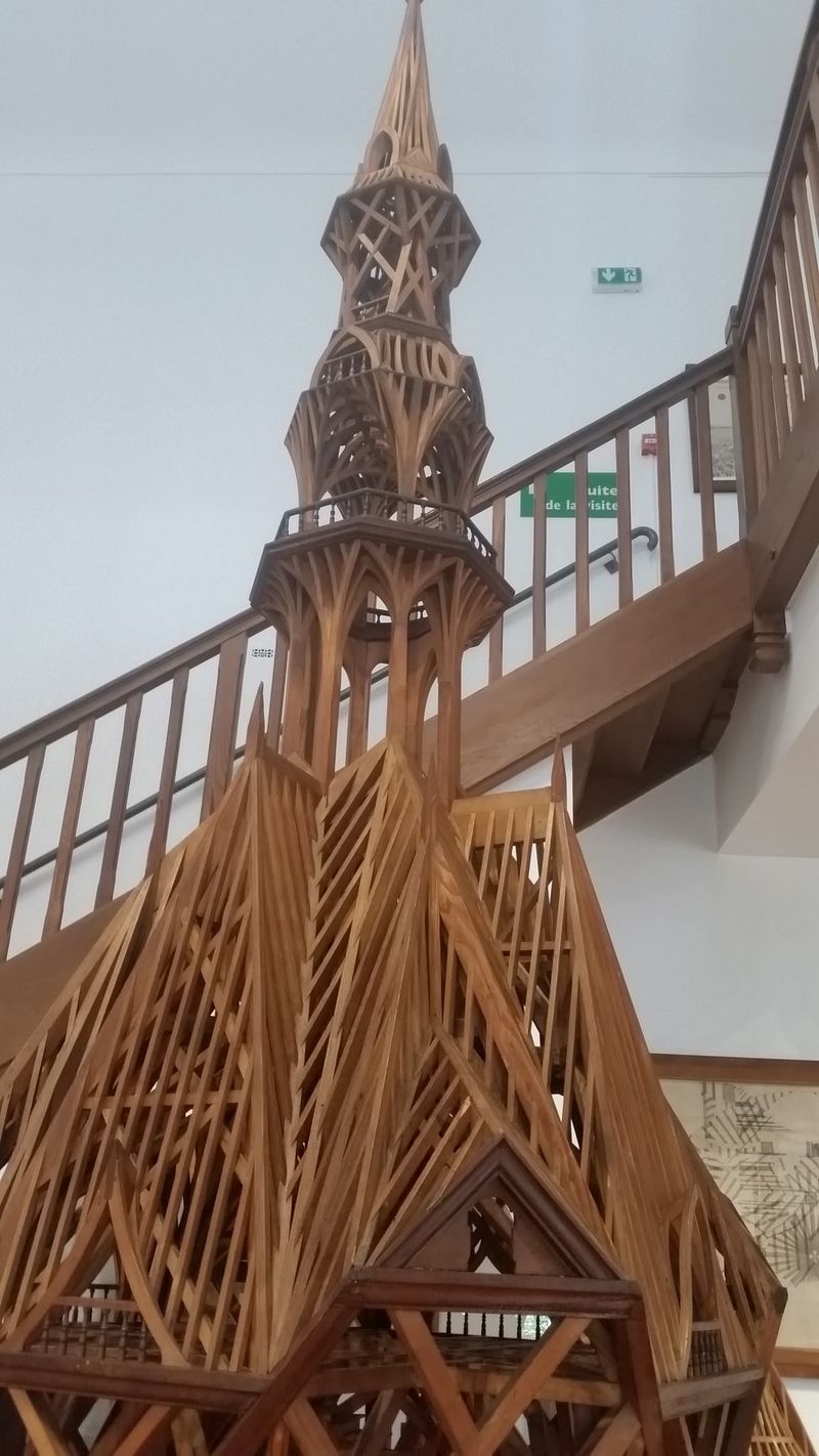

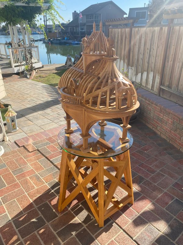

Have you guys heard of stereotomy? It seems to mostly apply to wood/carpentry, but also can be applied to stone.
I think this stuff is amazing.

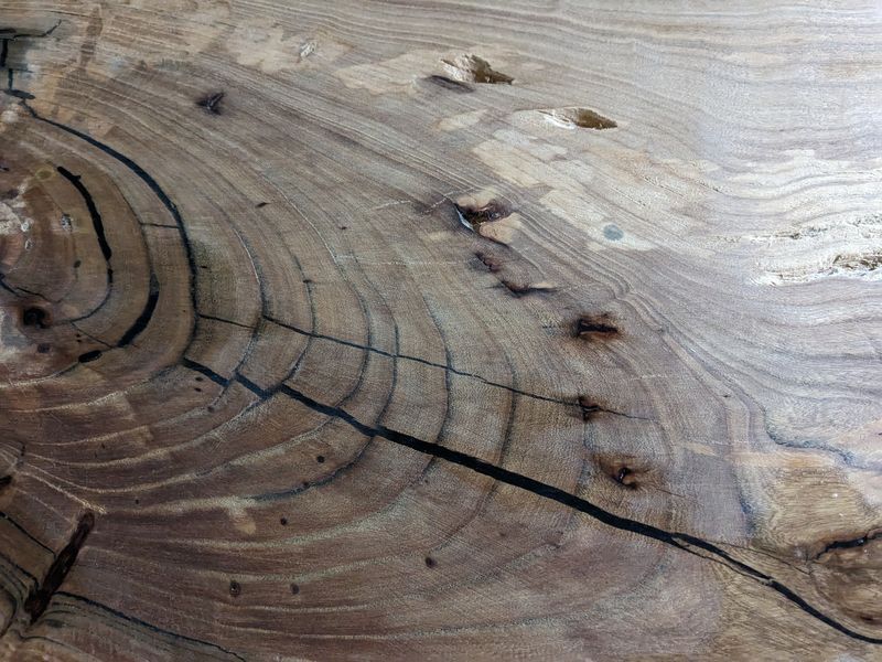

Some methods to the madness... I like to fill checks, ring shakes, spilts with resin prior to applying the finish.. the reason is it seems like bubbles loves to escape from the defect right after the epoxy has kicked.. no bueno..
In this case the Elm is a light wood so I added black pigment to the resin before filling the defects... and in reality they are not defects.. they're character..
http://forums.pelicanparts.com/uploa...1718055264.jpg
Cleaned up a bit with a belt sander... Ill bring this back to the shop and have them use the 52" drum sander to clean up the remaining shadows from the pigment..
