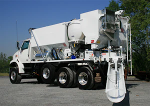

You also might find a 2-3 man crew that will mix on site . And some concrete companies have smaller trucks for odd situations where the big boy can't go . That's in addition to the already mentioned pumper trucks . Delivery method should be discussed with each quote so no additional damage occurs .

Also find out if suppliers around you have what we call Z mixers.. They are basically mobile concrete batch plants.. they carry the basic ingredients for concrete, and can mix different concrete mix designs, add admixtures, on site, on the fly.. much better than having someone hand mix bags of Sakrete
